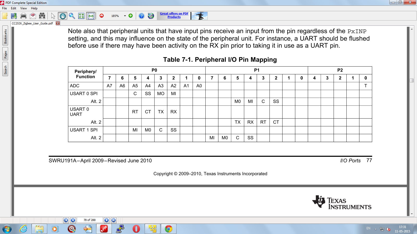

  • Although i check clock waveform on P1_5 but no waveform is observed ,
    Although  i am using Alternate-1 for USART-1 for  SPI as per mentioned in datasheet of CC253XX in
    and
    PORT pin as
    I have configured in master mode CC2530 with following pin
    i)P0_2 as chip_select for mmc SPI_CHIP_SELCT
    ii)P0_3 as serial clock SPI_CLOCK
    iii)P0_4 as SPI_MOSI
    iv) P0_5 as SPI_MISO
    I am also posting snap shot of port config details taken from CC253XX.pdf datasheet
  • Try to use the following red part of XNV_SPI_INIT to replace yours.

  • Just test the following USART1 PORT0 SPI init function and confirm to see SCLK on P0.3.
