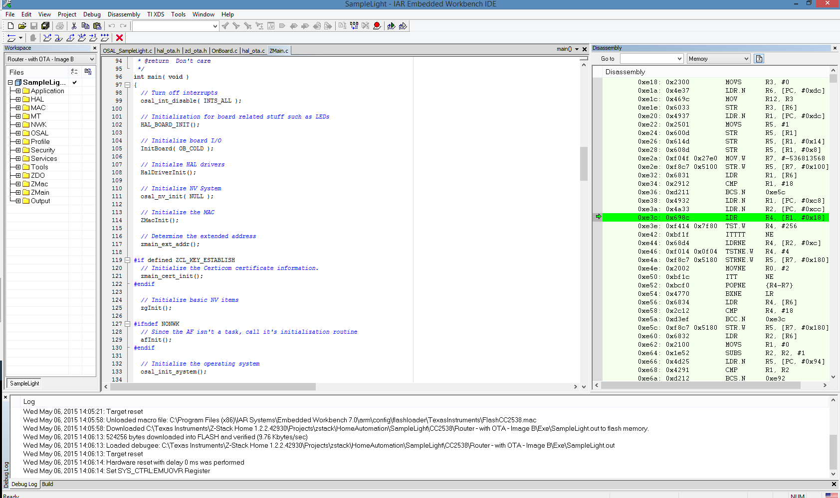

  • adding that folder to include solved the compiling problem. However, the program get stuck on ROM when I compile and load the new SampleLight with OTA client functionality. Something on the config or hal_ota.c/.h causes problem.

    Output Converter: binary (intel extended does not change the result)
    Linker > Config: $PROJ_DIR$\..\..\..\Tools\CC2538DB\CC2538-OTA-Image-A.icf
    Is there any include or definition that seem wrong to you?
  • What do you mean the program get stuck on ROM?

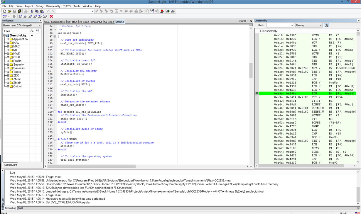

  • When I press "download and debug" button, it loads the program then loops between 0xe3c and 0xe5a
    When I remove the OTA configs and leave the default configs, the code starts from the main()
