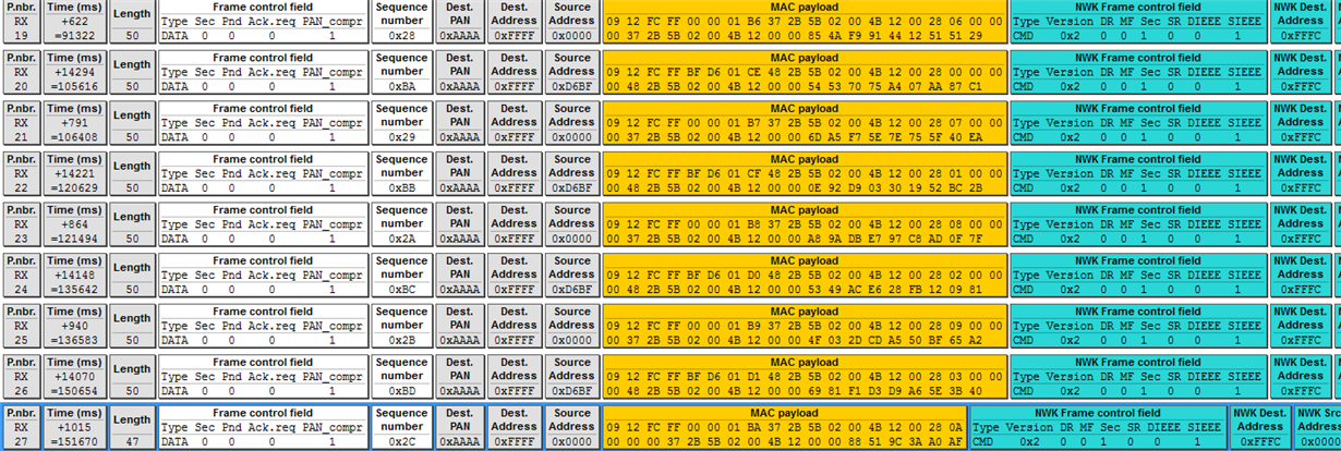

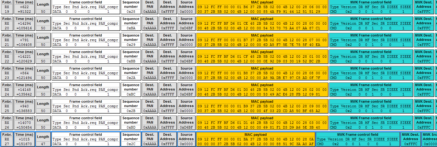

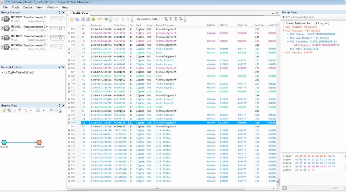

i joined the router to the above configured coordinator module.now i am sending continuously  sending data from coordinator to router.the data at router received continuously from coordinator with out fail.if i reset the router module while data receiving from coordinator at that time the data is not received at router.if i send the AF_Register and AF_start request commands to the module after reset then the module is data receiving the data.i enable the NV_RESTORE in the both module but i face the above problem.what is the reason for above problem?how can i solve it?
