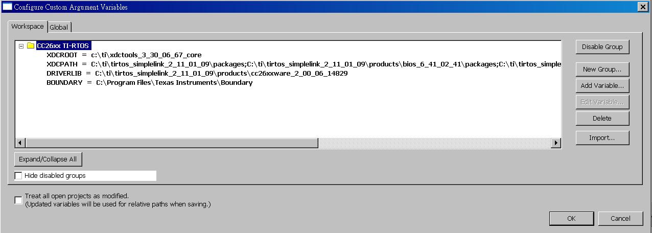

  • Check if you can see the following variables in IAR->Tools->Configure Custom Argument Variables
    If not, you can import it from C:\ti\simplelink\zstack_home_1_02_02_42930\Projects\zstack\HomeAutomation\SampleDoorLock\CC26xx\SampleDoorLock.custom_argvars
