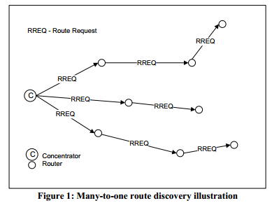

Dear YK Chen
Upon receipt of the route request, every device adds a route table entry for the concentrator and stores the one hop neighbor that relays
the request as the next hop address. No route reply will be generated.
With out route reply how the routing table is formed for concentrator at each router.

1. As I replied you in previous post, you can create another ZR to collect data as backup. You can send binding request to all nodes to binding them to this backup ZR so all nodes would also send a copy message to this backup ZR.
2. You have to define CONCENTRATOR_DISCOVERY_TIME in f8wconfig.cfg or compile options by yourself. There is no default value.
3. Do you read the application note "How to break 400+ node…"? It shows you how to enable many-to-one routing. It is not enabled by default.

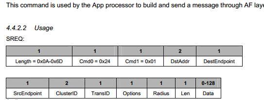

Dear Yk Chen
1.I formed a network with one coordinator and 3 routers.in my network 2 routers(R2,R3) are bind to the remaining router()R1.i want to send a message to coordinator from R2 using following command.
in above command i place the 0x0000 is placed in the field of destination address.my doubt is
is the message from R2 received only coordinator or coordinator and R1?
you told that one copy of message send to the backup collector.
Dear YK Chen
in that command we can put only one device 64-bit address in the destination address field then how the ZC and backup module receive the data at a time?
