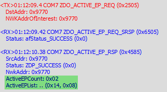

          I want to implement MT command responses to be received through uart in hyper terminal. Can anyone please help me solve problem in receiving AF_INCOMING_MSG MT command response in hyper terminal? My zed(temperature sensor) is sending data every 10 secs as i can see in sniffer log and also it hits breakpoint when ZC(thermostat) receives data but i am not able to receive AF_INCOMING_MSG MT command response in hyper terminal or z-tool.

  • I do the following steps and there is no problem to receive AF_INCOMING_MSG and other ZDO related message.
    1. defined MT_ZDO_CB_FUNC,MT_AF_FUNC,MT_AF_CB_FUNC,MT_NWK_FUNC,MT_NWK_CB_FUNC
    MT_ZDO_MGMT in SampleThermostat example which acts as ZC.
    2. Add #include "MT_AF.h" in zcl.c and add the red line in zcl_event_loop()
          if ( *msgPtr == AF_INCOMING_MSG_CMD )
            zcl_ProcessMessageMSG( (afIncomingMSGPacket_t *)msgPtr );
            MT_AfIncomingMsg( (void *)msgPtr );
    ZTool output:
  • Hi Yikai,
    Thanks a lot helping me solve this problem.  Now i am able to get both ZDO and AF responses.
    But if i request Active EP request i get two EPs. Why? if i request simple desc  then response is received for EP 0x08 but not for EP 0x14. I am using original z-stack and didn't add extra EP.
  • What example is your ZED based on? Is it still SampleTemeratureSensor?

    It is register by "afRegister( &sampleTemperatureSensor_TestEp )" in zclSampleTemperatureSensor_Init(). You can disable it.
  • Ya. Now i am getting single EP 0x08. Thanks.
