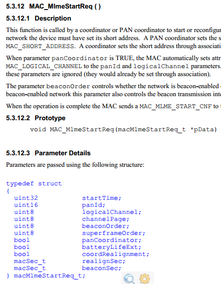

Dear Yk Chen
1.Can i call these functions directly in main loop of cc2538? or is there any care to follow to call these functions
2.If i call the Nlme_startup function in the main loop of cc2538 then who will assign the device short address?
3.is it possible the simulation in IAR without having the hardware?if possible please tell how is it?
