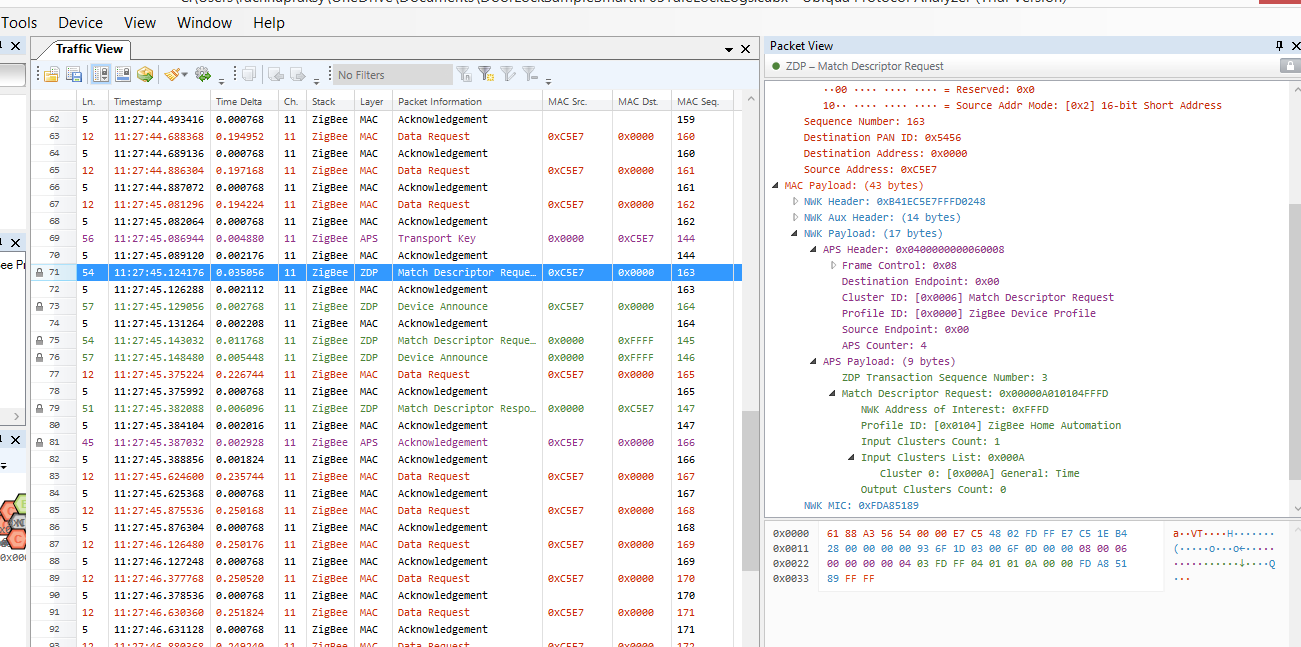

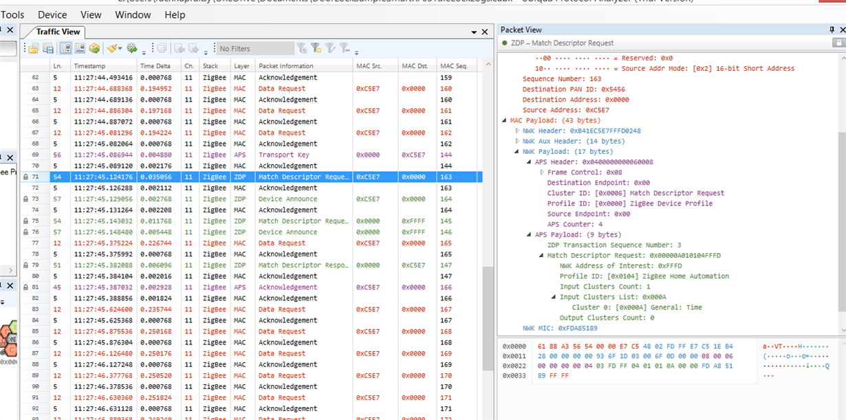

  • I suggest you using Ubiqua Packet Analyzer to check over the air messages to know what happens.
    We disabled security and HOLD_AUTO_START and then re-flashed ZC: DoorLockController image onto the CC2530 RF board. When we tested this time we see that the door lock sends a Match Desc Req and so does the RF board. The RF board responds with a Match Desc Resp. However we do not see such a response from the door lock.
    Below is a snapshot of the logs. Is there a way for us to share the actual logs with you?
  • You can click on "Useing Rich Format" at the right-bottom corner outside edit box. After it turns to rich format editor, you can drag and drop the log into edit box.
  • If you have a detail look on the screen shot of UBIQUA LOG,you would see the match request is sent from ZED (should be Yale Door lock) and your ZC responses it.

    2. Scenario 2: 1 RF Board (ZC) and the Yale lock (ZED)
    In this case we see the following call flow:
    -Assoc Req
    -Assoc Resp
    -Permit Join
    -IdentifyQueryReq (ZC ---> ZED)
    We do not see a IdentifyQueryRsp from the door lock
    -MatchDescReq (ZED ---> ZC) Here the clusters advertised  are TIME
    -MatchDescRsp (ZC ---> ZED)
    We can then see ReadAttribute from teh Lock for the time and a response from the DLC that states that it is not supported.
