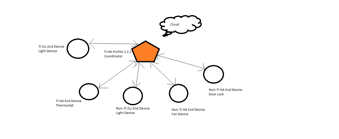

I am trying to understand ZigBee Profiles and I had a question regarding the inter operability between HA and ZLL Profiles Devices.
Suppose I have a HA (Coordinator) Device (TI HA Profile 1.2.2) and there are other HA End Devices (TI Devices + non TI Devices) along with ZLL End Devices (TI Devices + non TI Devices).
Then can this HA (Coordinator) Device, act as a common gateway to all these end devices (HA End Device + ZLL End Device) ?
Also, can this HA (Coordinator) Device, control these end devices i.e. send ON / OFF Commands and other Cluster specific commands which each device may have (device specific Clusters i.e. HVAC / Closure / Lightning / etc.) ?
I have a TI ZLL kit having the ZLL Remote + 3 OSRAM Light Devices. So to do the Light Link Pairing, we need to keep the Remote and the OSRAM Light Device near each other. So is it mandatory for the Coordinator Device and the End Device to have a close proximity to be connected / paired ?
Please do let me know if I need to elaborate the scenario.
