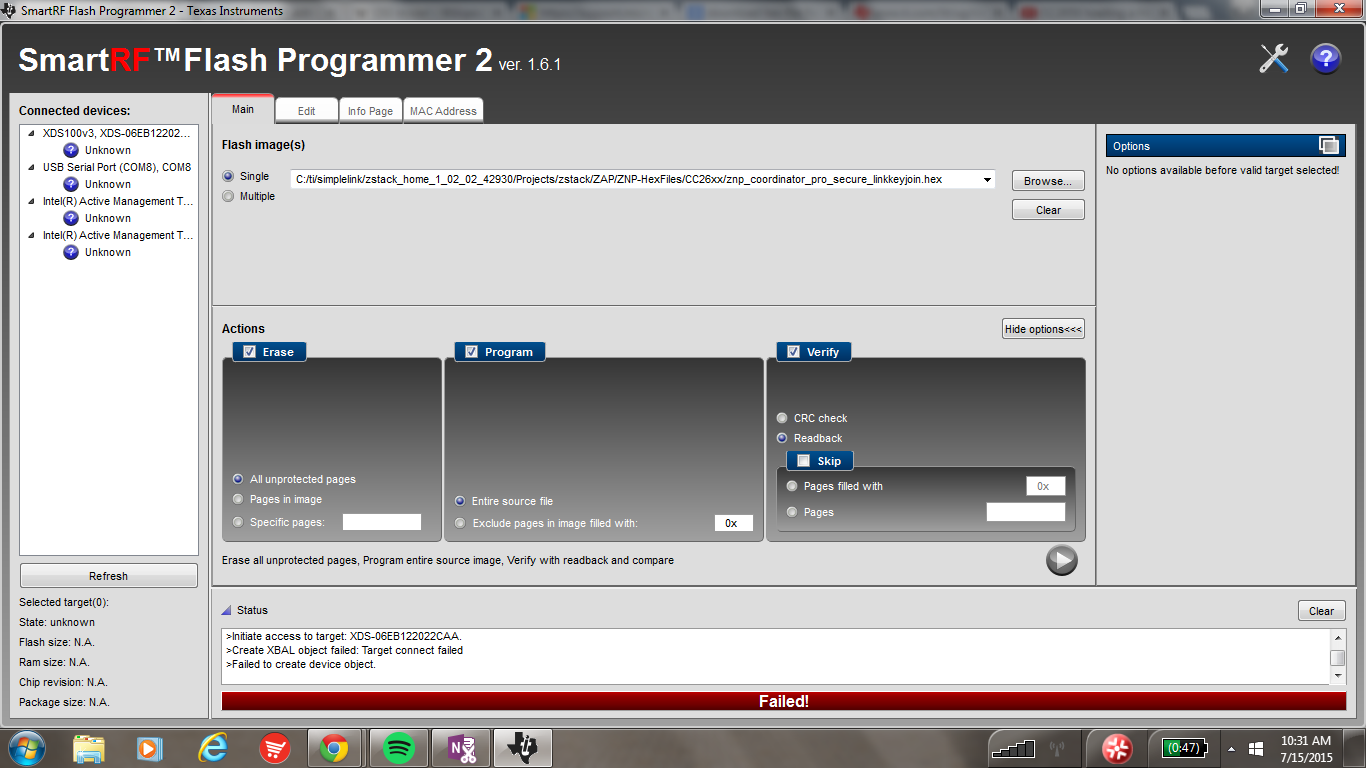

  • Hector,
    I attempted to use the flash the board, but it keeps failing. This is the screen I am getting:
    Do I have to put the device in bootloader mode? What does that mean?
    Thanks so much!
  • You should be using the XDS100v3 to flash the board instead of the USB Serial Port because otherwise you need to make the board go into boorloader mode.
    click the refresh button and under XDS100v3, XDS-06EB12202... it should say CC2650 instead of unknown if that doesnt happen make sure the CC2650EM is properly mounted on the SmartRF06.
    If this for some reason doesnt work then try doing a flash erase using IAR and try to flash the board again with Flash programmer 2

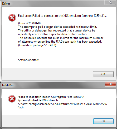

  • So I haven't done anything different from before, but I decided to try and start all over, because I thought I'd try something different. I uninstalled/ deleted all the TI folders and everything that had to do with the Z-Stack and Home automation etc. After re-downloading, I tried following the instructions on the home sample application user's guide. When I do step one, however, in an attempt to erase the memory, I get this error. I then decided to try and skip this step, but not matter what I do, on both boards, this error message comes up. I haven't done anything different from before, so I am really confused on what's going on.
  • If you use Flash Programmer 2, can you download any hex file under C:\ti\simplelink\zstack_home_1_02_02_42930\Projects\zstack\ZAP\ZNP-HexFiles\CC26xx to your CC2650DK?
  • No. Flash Programmer isn't working either
  • Can you attach a screen shot of your Flash Programmer 2?
  • In this instance, it isn't even recognizing the device. This happens about 80% of the time I plug the board in, and I usually try mass erase, which works sometimes but not this time. I tried loading a hex file into my other board etc and this happens, but then when I do the erase it works. It's just this board...

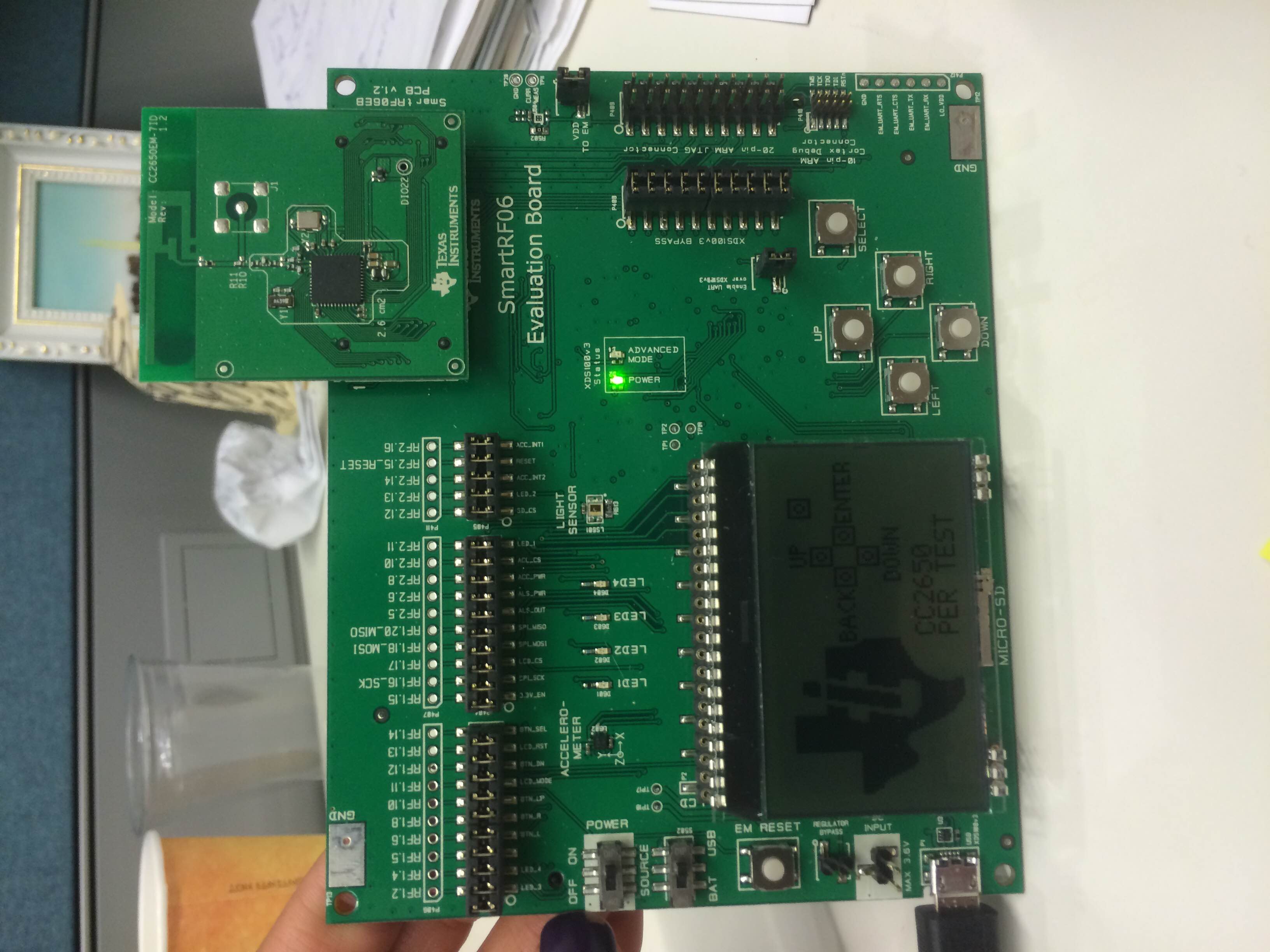

  • This looks your SmarRF06EB works fine. Can you take a picture on how you connect your CC2650EM and SmarRF06EB?
  • I know that the CC2650 is connected alright because the default screen shows
  • Yes, both your CC2650EM and SmarRF06EB look fine. This is really strange. I suggest you call TI local representative to help you.
