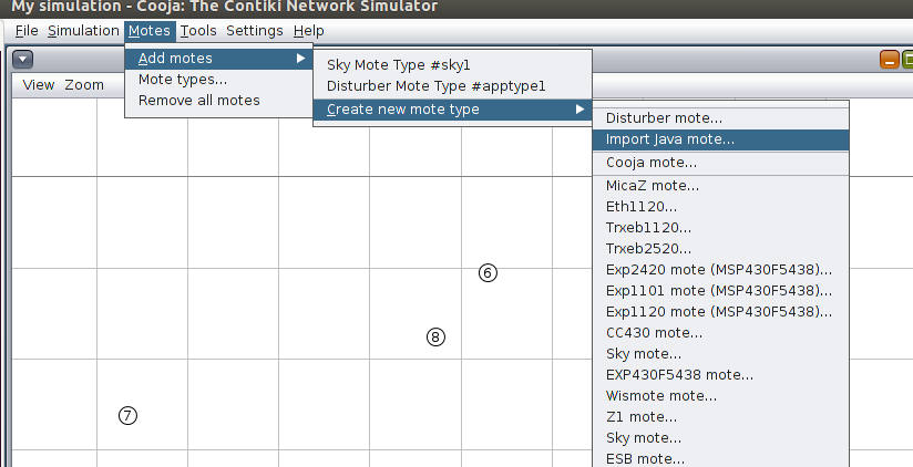

There is no CC2538 or CC26xx on Add motes menu. How can I use CC26xx and CC2538 as a mote on Cooja? Is there a mote file that I can import?
    There is no support for any ARM-CM3 cores in COOJA. From a network/system perspective I'd say that you get a good understanding of how the network is performing (simulation) by using the MSP430 architecture.
    There are various ongoing projects for supplying an ARM-CMx simulation environment, but currently I do not have any more information to share.

    Thanks for the reply. As I understand the new project will not so soon, do you know if there is any planned release date, autumn 2014, winter 2015, ..?
