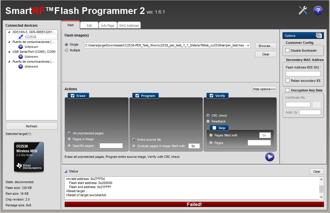

    I'm having similar troubles at 'flashing CC2538NF11 custom board' too.
    As programmer, I'm using the 'SmartRF Flash Programmer 2' and as interface the XDS100v3 connected to JTAG.
    After a dummy test, SmartRF is able to recognise, read the MAC of the board, but when I try to flash the 'per_Test.hex', flasher fails (please, take a look to attached).
    Is the 'per_Test.hex' valid for the 128kB flash and 16kB RAM of the CC2538NF11?
    Or maybe, is it another kind of error? In such case, how can I modify the example code in order to test it?
    Kind Regards!
  • I don't think default per_Test.hex would be valid for CC2538NF11. If you intend to test RF performance on CC2538NF11, you can try to use SmartRF Studio.
  • Hi ,
    the target is not test the radio performance, it is to be able to flash new firmware to the boards.
    In my case, 'per_Test.hex' is compiled for CC2538SF53, so this could be the reason of the failure. Then, I'm going to develop some 'testing code' in order to check my custom board I/Os, before flash any (Zigbee stack + custom fmw).
