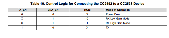

Hi Ti
1.how can i achieve this modes as shown in following table.
2.is above modes are achieving through hardware or firmware changes?

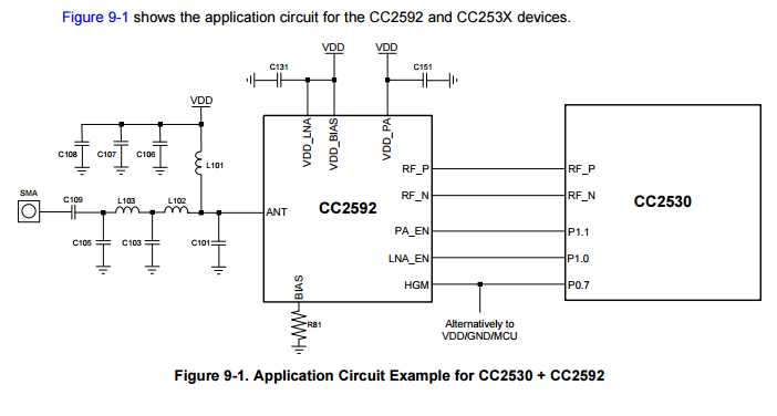

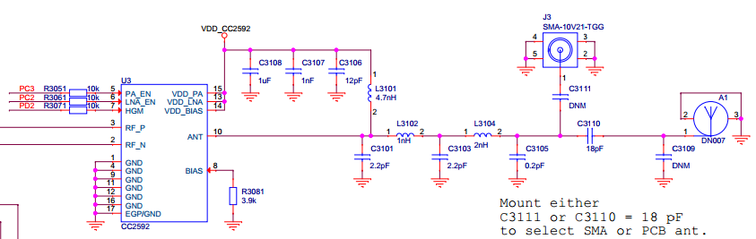

1. First, you have to use CC2538+CC2592EMK.
2. You need to define HAL_PA_LNA_CC2592 in your application.
You can refer to Application note: Using CC2592 Front End With CC2538.
