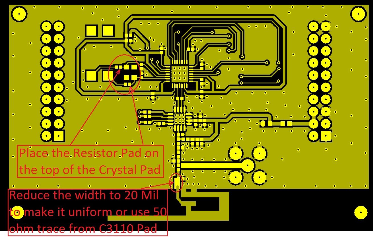

Please help me,
                                  I would like to know,Is it possible to design (CC2538+CC2592 or CC2520+CC2592) in double side board? ,because in TI CC2592 reference design 4 layer pcb board use.  i am also ,from one of board, from these two design to make compatible to attach bluetooth receiver ic ,so ,is it possible to design one range extender,one mcu,one bluetooth receiver ic in one double sided board?In my project  i have smart metering application,in which we would like to use zigbee for electricity meter reading,and bluetooth for mobile connectivity use any android or apple mobile connectivity ,and mcu to control pc communication and these  other ic control.
