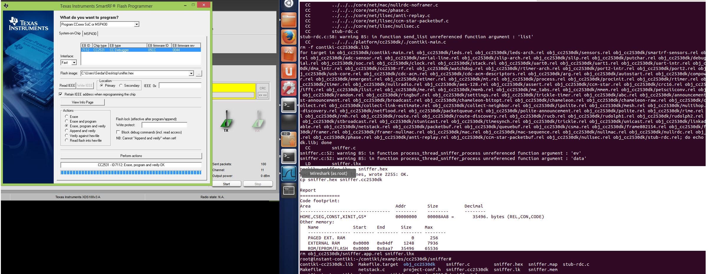

  • Thanks for the reply.
    On the right window, the sniffer.hex is successfully compiled, the left window shows that the .hex file is uploaded successfully to the CC2531 dongle.
    I can't see the dongle on Wireshark list neither on Ubuntu nor Windows. Ubuntu enumerates the dongle as /dev/ttyACM0. according to https://github.com/g-oikonomou/sensniff  it should be /dev//ttyUSBx
    python sensniff.py -d /dev/ttyACM0 doesn't sniff anything.Is it .hex file related or ubuntu configuration related problem?
    When I plug the usb dongle to a USB port, the red LED blinks once and I don't see any green LED. Is it a normal behavior?
    It would be a lot easier if someone could share the correct .hex file
    When I connect it to Ubuntu PC (or Windows), I don't see it on Wireshark list. ubuntu enumerates it as /dev/ttyACM0. I guess the correct enumeration should be /dev//ttyUSB0
    python sensniff.py -d /dev/ttyACM0 doesn't sniff anything. I don't know what is wrong. But, I suspect the sniffer code is not correct although it says it was compiled correctly.

    Thanks for the reply and sharing the .hex file. I have just uploaded the firmware on my two cc2531 dongle (I have just opened the box of one of them) . However, none of them work correctly. First the green and then the red led blinks When the dongle is plugged into my laptop,  then nothing happens. cdc_acm driver enumerates the dongle as /dev/ttyACM0, but I guess sensniff can't communicate with the module. I run the below command then use smartRF studio 7 to transmit packets from CC2650DK.

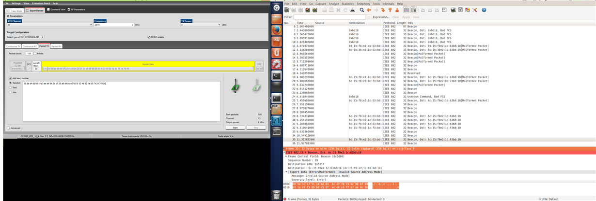

    I got a one time kind help from the developer. The LED should only blinks once at the boot, then goes to "silent" mode. So, it is a normal behavior that LEDs are not ON as the ZigBee sniffer.
    Mike's firmware and the firmware that I was building myself are working OK with 2 problems:
    1)The usb dongle works at channel 13 by default and I can't manage to change it via sensniff. I don't know why the program doesn't react when I enter one of the following inputs "n, 11, c, 12, c, 13, c, ..., 26". Does anyone know how to change the sniff frequency?
    2) I use smartRF Studio 7 + CC2650EMK to transmit 100 packets (7 byte) at channel 13. The CC2531 dongle and CC2650EMK are 10 cm apart. However, the sniffer can only pick up 70ish of them. Is there anything to do to improve the sniff performance?
    A correction: I have Rev 2.4 of CC2531 dongle, not 4.1(probably not exist)
    EDIT:
    I have just noticed that the destination address of the received packet blank, 0xbd10, or 69:15;f0... and most of them have [Malformed Packet] sign, does the sniffer have an issue to sniff the packets reliably?
