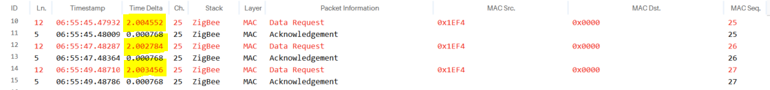

  • Hi ,
    I don't think that you have the same problem, as I didn't found any NWK Leave packet in your sniffer log. You probably have some issue with Identification mode, but this is different topic.
    As for polling interval, it can be defined from your sniffer logs as 2 seconds (see screenshot below). As far as Data Request packets get Acknowledgment packets in response, communication with sleeping device is OK.
    As for required settings on XBee side (coordinator), there are 2 parameters for that purpose: SP (Cyclic Sleep Period) and SN (Number of Cyclic Sleep Periods). As far as poll timeout (see screenshot below) is larger than sleep period of your end device, communication should be fine. For example, in your case I would assign SP to 0xD0 (2080 ms) and SN to 0x01, which will give poll timeout above 6 seconds (enough to be on safe side). For small static networks it should not be a problem to set this value even large.

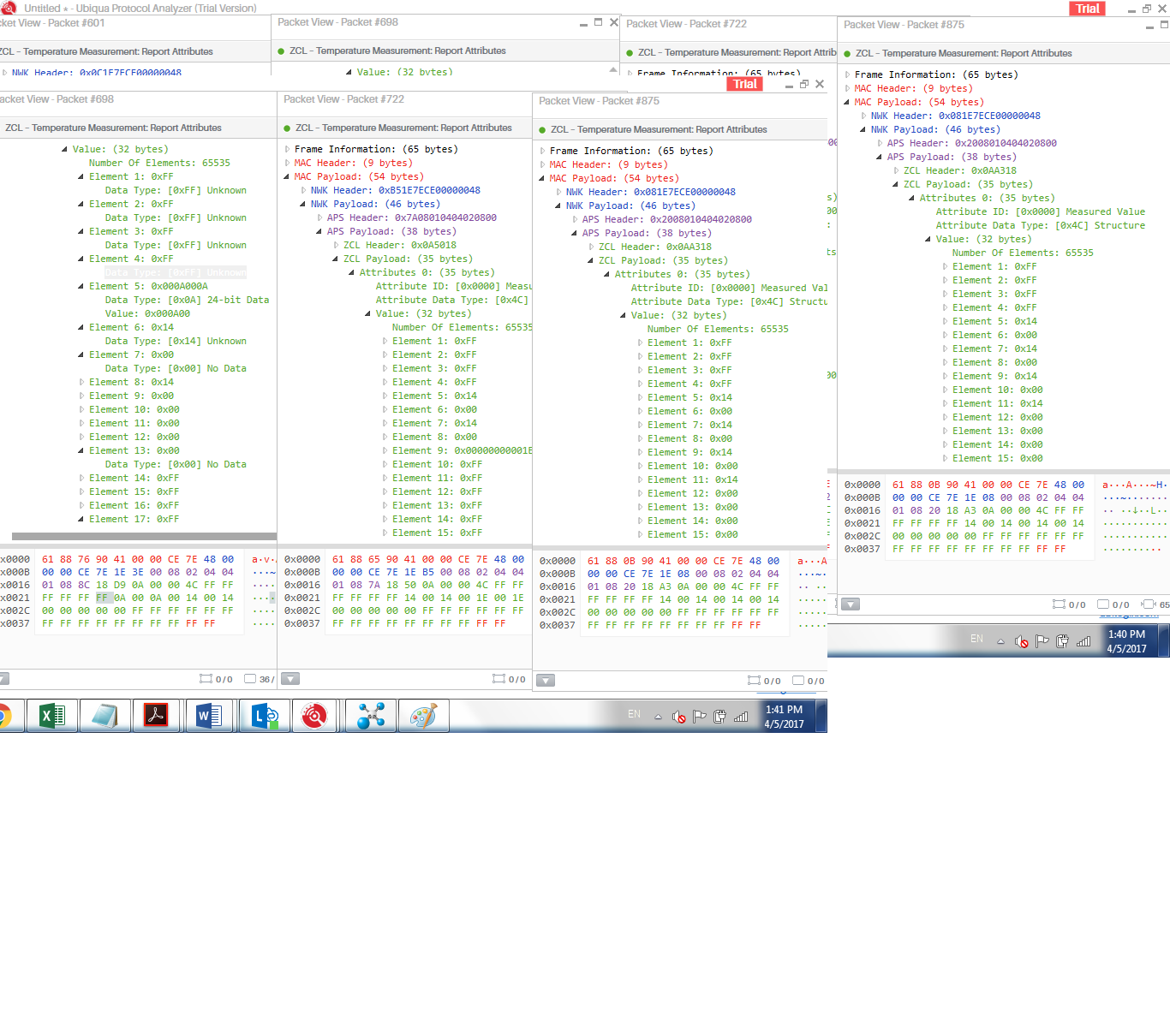

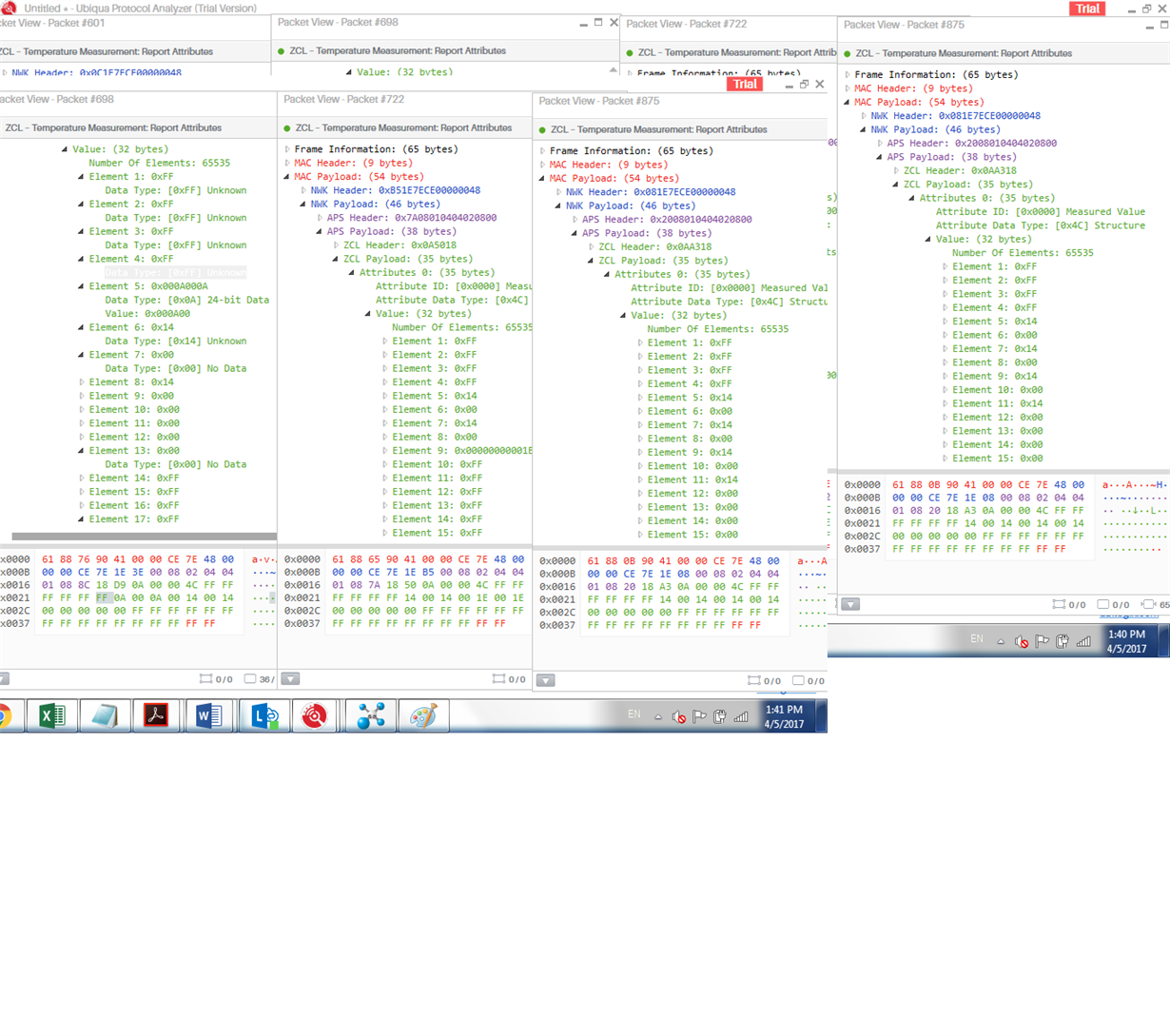

    but i am not able to get RF data frame from the end device
    In CC2538 as a ZC - all the communication as per desire - ZC and ZED works fine
    But In Xbee- S2c As a ZC - I am not getting main RF data frame which is 65 byte
    i have attached both the logs here - pls help

    I would like to confirm about the Xbee S2C supports Temp sensor measurement cluster - Cluster ID- 0X402 or not?
    If it supports then i have to look in to different area
    i am doubtful about the Xbee support to cluster 0x402
    if, it supports cluset 0X402 ZCL then
    What setting you did in the XCTU tool pls share the snippet
  • Hi ,
    XBee itself doesn't have application running on board. It acts as radio with ZigBee stack. So, there should be no problem with compatibility with particular cluster ID as XBee simply forwards encapsulated APS frame to the host controller over serial interface. As I understood, you are experiencing problem with passing through messages to the serial interface. I would suggest to try AT command AO to be set to 0x03, 0x07 or 0x0B.
