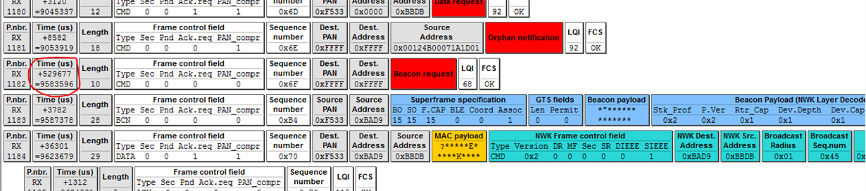

ED rejoin to NWK it will cost a lot of time in beacon request and need two times to send the NWK rejoin request. how to reduce these time.
Hi YiKai,
Thanks for your reply, i had already changed NUM_DISC_ATTEMPTS to 0 and i find reduce two times Superframe specification but also need two times beacon request after i check the psd file. BTW, how to reduce the Beacon polling time? thx
