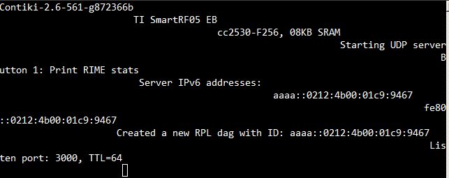

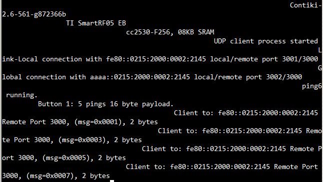

Hello there,
I am trying to test Contiki example programs on a custom CC2530 board. However, they can not receive data each other.  When I am using SRF06EM+cc2538EM, every example works fine.
I had tested  examples,  rpl-udp/, simple-udp-rpl., with SDCC 3.4.1 #9092, contiki-sensinode-cc-ports programs on Contiki 2.5, 2.7, and 3.0.  I think they have no connection with each other.
 When I had ported Z-stack on the board, it worked fine.  The following figures show my problem. Please help me.
Byungsoon
