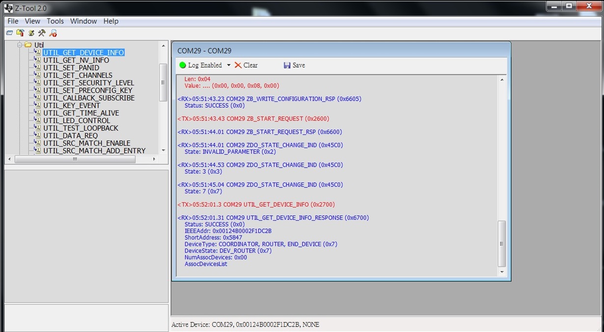

    <TX>12:02:18.28 COM23 ZB_START_REQUEST (0x2600)
    <RX>12:02:18.3 COM23 ZB_START_REQUEST_RSP (0x6600)
    <RX>12:02:18.3 COM23 ZB_START_CONFIRM (0x4680)
    Status: INVALID_PARAMETER (0x2)

  • You have to setup coordinator first. Otherwise, you will keep seeing "Status: INVALID_PARAMETER (0x2)".
  • Can be, but for the CC2650 coordinator, router and endevice have separate ZNP images. I forgot that totally because I'm used to just one image. If you look at the CC253X images that distinction is not there .
    So with the router image in place start_request still returns 0x2 (for the above reason, i have to see) but does not keep on looping.

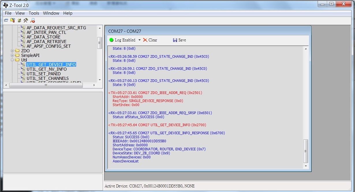

  • My coordinator has ShortAddress: 0xC65F
    So why does sending the below command at the coordinator not repond in any data reception in the router screen? (this is done so straight forward at the ZigBit)?
    <TX>02:21:34.19 COM21 ZB_SEND_DATA_REQUEST (0x2603)
    Destination: 0xC65F
    CommandId: 0x0000
    Handle: 0x00
    TxOptions: NONE (0x0)
    Radius: 0x00
    PayloadLen: 0x05
    PayloadValue: AAAAA (0x41, 0x41, 0x41, 0x41, 0x41)
    <RX>02:21:34.21 COM21 ZB_SEND_DATA_REQUEST_RSP (0x6603)
  • In the above, I means my router has 0xC65f. so sending from coordinator to router.
