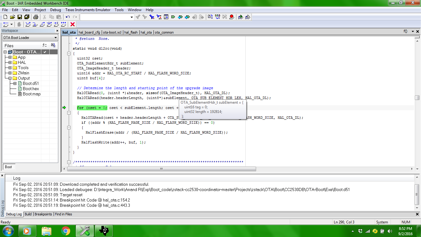

HI Yikai,
I have done the image writing in the EXTERNAL Flash Memory via SPI using CC2530 and Image downloaded from OTA Dongle ( Coordinator ) is SUCCESSFUL and Node is restarting also,
Now I have edited the f8w2530 config file as per the ota.xclZ-Stack OTA Upgrade User's Guide.pdf
CODE_START - 0x0800 ( earlier it was 0x0000 )
and added CRC Option
I have done the integration of hex files of Boot Code and Node Firmware also as per the steps mentioned in page 44 of the pdf attached here with,
I have found the boot code is not able to execute jump to 0x800 location
then I tried debugging that and TRIED to check the function dl2rc()
and i found if i keep only two things in the boot code
one is dl2rc()
and other one is that JUMP instruction to 0x0800
again the integrated code ( Boot + Node Firmware ) is not working ( it means the boot code is not able to execute Jump Instruction to 0x0800 )
So Finally in the boot code I disabled the function dl2rc() and keep that Ljump instruction ( 0x0800 )
the Running code started working
like the Node Device announce and every thing as usual like the how the node firmware works
what could be the problem ?

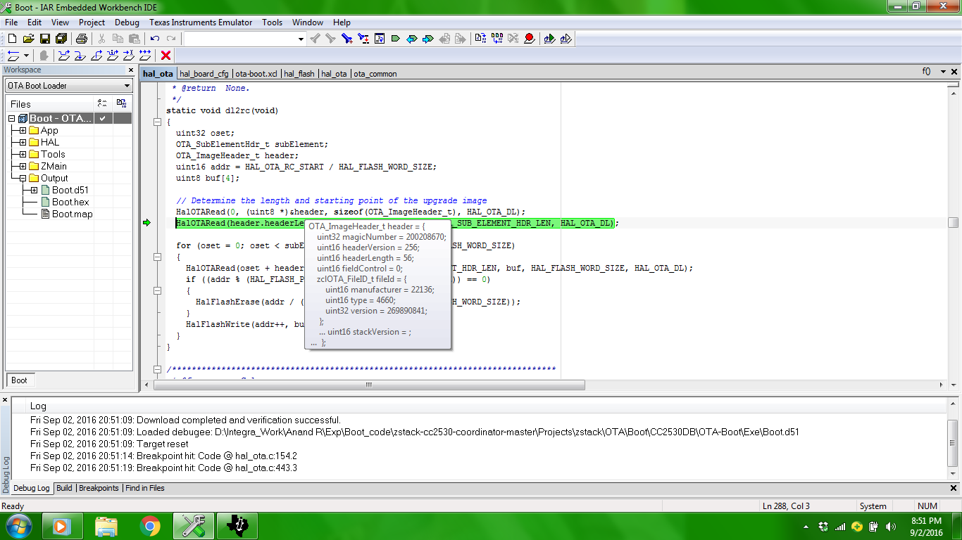

Hi Yikai
after lot of findings
I have noticed one difference
I created two hex files
1.>< One with Download to RC function >
2.>< one WITHOUT dl2rc function >
and burnt the hex file and READ back the two hex files from MCU to PC using read_flash Option
The header string varies in the two cases
1.> RED COLOUR Pop up - when dl2rc() function is included in the Boot Code
2.> GREEN Colour Po up - WITHOUT dl2rc function
I am running out of idea, what is your Suggestion on this
can it be the reason ?
