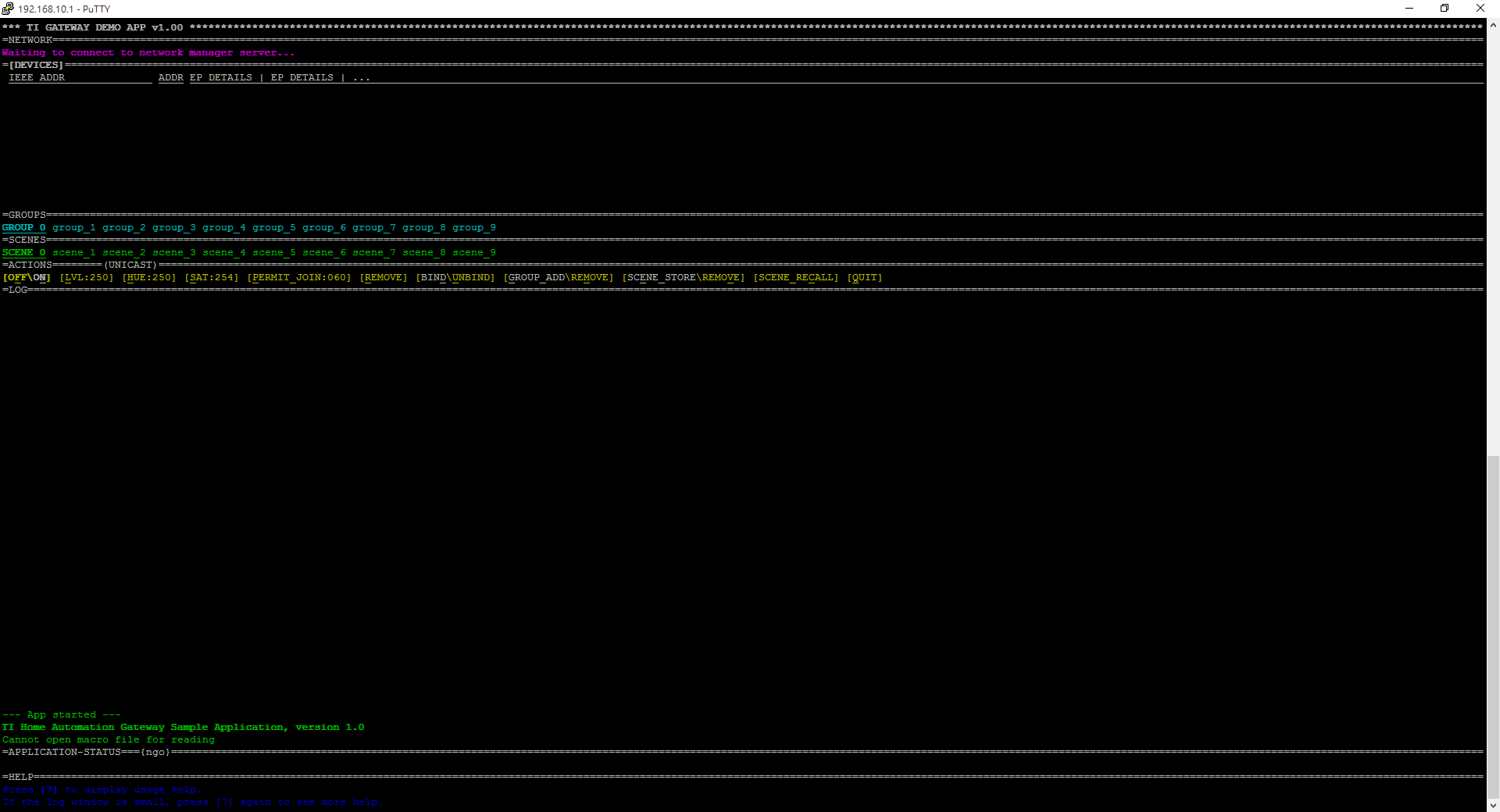

My result:
If I inputted this line
endpoint { 7, RelHumidMesureEpDef, RelHumidMesureAttrList}
I always got this error [Cannot open macro file for reading] .
If I didn’t input that line, it worked like before I modified gateway_setting.tlg file.

  • Hi OD,
    Do you know why I didn't see "Cannot open macro file for reading" if I removed this line "endpoint { 7, RelHumidMesureEpDef, RelHumidMesureAttrList}"?
    -TJ
  • I think I need to explain more clear.
    Like my previous description.
    When I inputted endpoint { 7, RelHumidMesureEpDef, RelHumidMesureAttrList}, it always shows something like below
    It always shows "Waiting to connect to network manager server..."
    Can anyone help?
    Thanks!
