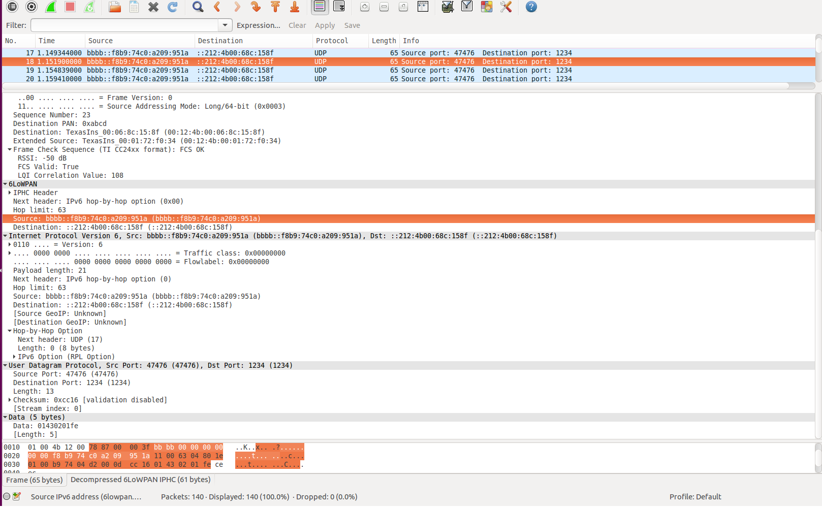

We have similar setup as 6lbr-example1 has:
- 6lbr on RPI is compiled from the source code on GitHub
- One srf06 + CC2650EM is on the 6LoWPAN side. The node has "aaaa::212:4b00:68c:158f" address
I send a UDP unicast packet from the PC. Here below is a Wireshark capture from the PC. The destination address is correct as it is seen below.
I use Sensniff at another PC and here is its capture
The destination address is shown as ::212:4b00:68c:158f (aaaa part disappears? ). The packet has correct dest. MAC address, but L3 address is not correct. However, I see and ACK (L2 ack?). But, I don't receive any packet on the node
  • Here is another wireshark capture from sensniff while I ping the node from the PC.
    Both UDP and ping makes its way to the node as I can see the node sends L2 ACK after it gets the packet. However, I guess the UDP packet can't go to the layer 3 as the destination address is wrong.  Why does the destination address change and how I can solve the issue?
