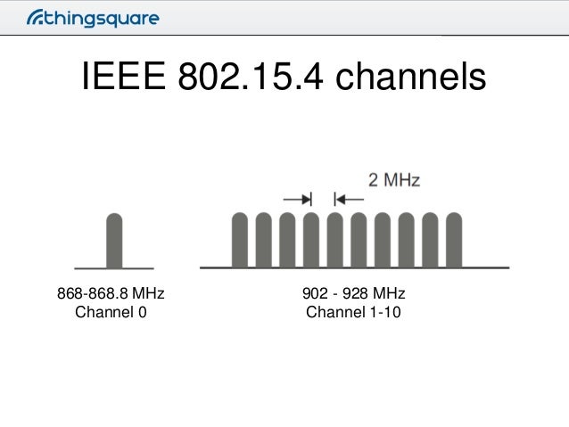

I am concerned with the default channel being set to 25 - this seems appropriate for 2.4GHZ band, but not for sub GHz (802.15.4 does not have 25 channels below 1GHz).
1) How do I set the frequency for CC13xx - for use in Australia so somewhere 915 - 925 MHz range?
