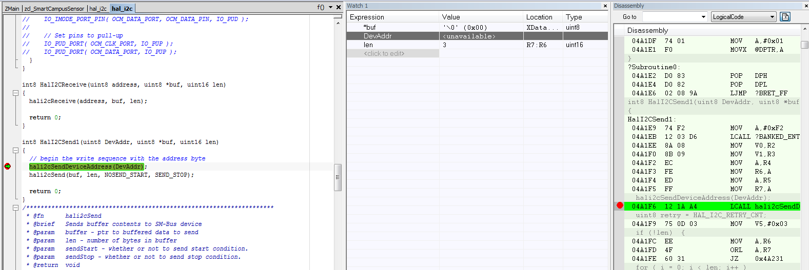

4) I simply call the function as below. But the address value doesn't pass the function inside hal_i2c.c.
uint8 OPT_txBuf[3] = {0};
HalI2CSend(0x44, OPT_txBuf, 3);
One strange that only address value doesn't pass. I see *buf and len value. What could be wrong?
int8 HalI2CSend(uint8 address, uint8 *buf, uint16 len)
I debug this issue for two days already but I still can't solve it. What could be the problem?
