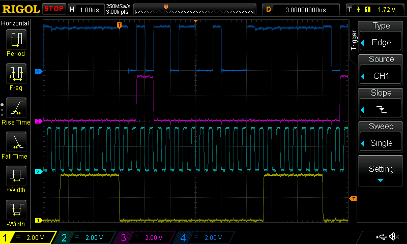

  • I have managed to get an 8 MHz MCLK running on DP0.
    BCLK and WCLK are static low for some reason.
    I have mapped those to DP1 and DP2 for convenience, but they are idle.
    Something else I am noticing is that AIFWCLKSRC is getting cleared in my main loop, which does nothing except print the register values.
    AIFWCLKSRC = 2 when I go into the loop, which is what I want.
    BCLK is disabled when I set that register (as instructed in the TRM), then re-enabled before the main loop.

  • Hi,mike. Does that work?Can you recieve data from cc2650 microphone?
  • All this code manages to do is produce an 8MHz MCLK. No BCLK is generated, so no bits are coming out of the microphone. I am quite confident I can convert the data to something useful in firmware, once the I2S bus is functioning as desired.
    I have not received support in any form about this, despite 2 posts in this thread, and an older thread that I had given up on and deleted.
    If anyone can get the I2S bus functioning, I am happy to contribute some DSP firmware to produce PCM audio samples.

  • Thanks Andrei. I gave this a shot and the mystery behavior continues.
    Before entering my while loop, AIFWCLKSRC = 2.
    In the loop its getting set back to zero.
    No change in the measured clock signals.
    Have you had any luck with I2S on the sensortag?

  • Thanks Andrei, this is a solid example.
    Since I'm still on the sensortag, I had to make a few changes.
    BCLK is on DIO_11, with your example, I see a 3 MHz clock here.
    WCLK is on DIO_25, with your code, I see this signal go LOW for 16 counts of BCLK, and HI for 8 counts of BCLK.
    This matches your waveform.
    MICPWR is on DIO_13, I actuate that high when I enable BCLK
    AUDIO_DI (AD0) is on DIO_2, on the scope, I see the microphone output bitstream.
    I also had to change the pin direction for the I2S AD0 pin.
    You're the man. I owe you some beers if you're ever in portland!
    Cheers!

    flags = 0xf & HWREG(I2S0_BASE + I2S_O_IRQFLAGS);
    if (flags)
    i2s_terminate();
    else
    i2s_iter();
    if( index_table >= 254 )
    int i;
    i2s_terminate();
    i2s_extractData();
    //fft
    ifft(i2s_out, i2s_in, I2S_BUFF_SIZE/8);
    printf("I2S FFT:\n");
    for(i=0;i < I2S_BUFF_SIZE/16; i++)
    printf("\t%d\n", i2s_out[i]);
    for(i=0;i < I2S_BUFF_SIZE; i++)
    i2s_in[i] = 0 ;
    printf("\n");
    } else
    //i2s_extractData();
    * ======== i2s_init ========
    * Initialization Sequence implemented according to
    * <swcu117d.pdf> 22.9.1. Start-up Sequence.
    void i2s_init(void)
    index_in = 0;
    index_out = 0;
    ti_lib_ioc_pin_type_gpio_output(BOARD_IOID_MIC_POWER);
    ti_lib_ioc_io_drv_strength_set(BOARD_IOID_MIC_POWER, IOC_CURRENT_2MA,
    IOC_STRENGTH_MIN);
    // ti_lib_gpio_pin_write((1 << BOARD_IOID_MIC_POWER),1);
    ti_lib_gpio_write_dio((1 << BOARD_IOID_MIC_POWER),1);
    // step 1. Set up and configure required ADx and clock pins (set externally in the IOC module).
    // IOCPortConfigureSet(BCLK, IOC_PORT_MCU_I2S_BCLK, IOC_STD_OUTPUT);
    IOCPortConfigureSet(MISO, IOC_PORT_MCU_I2S_AD0, IOC_STD_INPUT);
    // TODO : What about WCLK? We're only using a single Mic (dummy for now)
    IOCPortConfigureSet(WCLK, IOC_PORT_MCU_I2S_WCLK, IOC_STD_OUTPUT);
    // TODO : What about MCLK? (dummy for now)
    //IOCPortConfigureSet(IOID_24, IOC_PORT_MCU_I2S_MCLK, IOC_STD_OUTPUT);
    // 2. Enable I2S peripheral and configure WCLK and MCLK audio clocks
    // (set externally in the PRCM module).
    PRCMPeripheralRunEnable(PRCM_PERIPH_I2S);
    PRCMLoadSet();
    PRCMPeripheralSleepDisable(PRCM_PERIPH_I2S);
    PRCMLoadSet();
    PRCMPeripheralDeepSleepDisable(PRCM_PERIPH_I2S);
    PRCMLoadSet();
    PRCMAudioClockConfigSet(PRCM_WCLK_SINGLE_PHASE | PRCM_WCLK_POS_EDGE,
    I2S_SAMPLE_RATE_16K);
    /*custom config for 2,4MHZ BCLK
    uint32_t ui32MstDiv = 1;
    uint32_t ui32BitDiv = 10;
    uint32_t ui32WordDiv = 15;
    PRCMAudioClockConfigSetOverride(PRCM_WCLK_SINGLE_PHASE | PRCM_WCLK_POS_EDGE, ui32MstDiv,
    ui32BitDiv, ui32WordDiv);
    PRCMLoadSet();
    // 3. Configure the serial audio interface format and the memory interface controller
    /* Set the following registers: I2S:AIFWCLKSRC, I2S:AIFDIRCFG, I2S:AIFFMTCFG,
    I2S:AIFWMSK0, I2S:AIFWMSK1, and I2S:AIFWMSK2.
    BCLK must not be running when changing the I2S:AIFWCLKSRC register. */
    I2SControlTable g_controlTable; // Define global
    g_pControlTable = &g_controlTable; // Assign pointer
    PRCMAudioClockDisable();
    I2SClockConfigure(I2S0_BASE,
    I2S_INT_WCLK | // Clock source (internal)
    I2S_INVERT_WCLK); // Clock polarity (not inverted)
    I2SChannelConfigure(I2S0_BASE,
    I2S_CHAN0_ACT |I2S_LINE_INPUT , // single phase chan 0
    0, // null for chan 1
    0); // null for chan 2
    I2SAudioFormatConfigure(I2S0_BASE,
    I2S_MEM_LENGTH_16 | // Sample size
    I2S_POS_EDGE | // Clock edge sampling
    I2S_SINGLE_PHASE_FMT | // Phase
    I2S_WORD_LENGTH_16, // Word length
    1); // bit clk delay format (1= I2s )
    I2SBufferConfig(I2S0_BASE,
    (uint32_t) &inBuf, // is the address of the input buffer.
    (uint32_t) &outBuf, // is the address of the output buffer
    I2S_DMA_BUF_SIZE_256, // is the size of the DMA buffers. Must be > 0!
    I2S_BUFF_SIZE); // is the size of the channel buffers.
    // 4. Enable BCLK (set externally in the PRCM module).
    HWREG(PRCM_BASE + PRCM_O_I2SBCLKSEL) = 1; // use internally generated clock
    PRCMLoadSet();
    PRCMAudioClockEnable();
    PRCMLoadSet();
    // 5. Configure and prepare the samplestamp generator:
    Set the I2S:STMPWPER register.
    This number corresponds to the total size of the sample ring buffer used by the system.
    Set the two registers I2S:STMPINTRIG and I2S:STMPOUTTRIG > I2S:STMPWPER
    to avoid false triggers before the samplestamp generator is started.
    HWREG(I2S0_BASE + I2S_O_STMPWPER) = I2S_BUFF_SIZE;
    HWREG(I2S0_BASE + I2S_O_STMPINTRIG) = I2S_BUFF_SIZE+1;
    HWREG(I2S0_BASE + I2S_O_STMPOUTTRIG) = I2S_BUFF_SIZE+1;
    // 6. Enable the samplestamp generator:
    Set I2S:STMPCTRL.STMP_EN = 1
    HWREG(I2S0_BASE + I2S_O_STMPCTL) = I2S_STMPCTL_STMP_EN;
    int32_t var = HWREG(I2S0_BASE + I2S_O_STMPWCNT);
    printf("WCNT\t%d\n",var);
    while (2 > HWREG(I2S0_BASE + I2S_O_STMPWCNT)){
    HWREG(I2S0_BASE + I2S_O_STMPWSET) = 0;
    // 7. Enable the serial audio interface:
    Set the I2S:AIFINPTRNEXT and the I2S:AIFOUTPTRNEXT registers
    for first memory interface buffers.
    Set the I2S:AIFDMACFG register;
    This number corresponds to the length of each block in the sample ring buffer used by the system.
    for second memory interface buffers.
    //register i2s interrupt
    I2SIntRegister(I2S0_BASE,I2SHandler);
    //I2SEnable(I2S0_BASE);
    i2s_iter();
    // DMA Buffer Size Configuration
    HWREG(I2S0_BASE + I2S_O_AIFDMACFG) = I2S_BUFF_SIZE-1;
    i2s_iter();
    // 8. Start input and output audio streaming:
    Set the I2S:STMPINTRIG and the I2S:STMPOUTTRIG registers
    so they correctly match the I2S:AIFINPTR and the I2S:AIFOUTPTR registers.
    I2SSampleStampConfigure(I2S0_BASE, true, false);
    I2SIntEnable(I2S0_BASE ,I2S_INT_ALL & (~I2S_INT_DMA_OUT) );
    // Current Value of WCNT
    while (5 > HWREG(I2S0_BASE + I2S_O_STMPWCNT)){
    // WCLK Counter Trigger Value for Input Pins
    HWREG(I2S0_BASE + I2S_O_STMPINTRIG) = 0;
    // WCLK Counter Trigger Value for Output Pins
    HWREG(I2S0_BASE + I2S_O_STMPOUTTRIG) = 0;
    index_in = 0 ;
    // Interrupt Clear Register
    HWREG(I2S0_BASE + I2S_O_IRQCLR) = 0x3F;
    //printf("I2S_O_AIFWCLKSRC:\t %08lx\n", HWREG(I2S0_BASE + I2S_O_AIFWCLKSRC));
    /* printf("PRCM_O_I2SCLKGR:\t %08lx\n", HWREG(PRCM_BASE + PRCM_O_I2SCLKGR));
    printf("PRCM_O_I2SCLKGS:\t %08lx\n", HWREG(PRCM_BASE + PRCM_O_I2SCLKGS));
    printf("PRCM_O_I2SCLKGDS:\t %08lx\n", HWREG(PRCM_BASE + PRCM_O_I2SCLKGDS));
    printf("PRCM_O_I2SCLKCTL:\t %08lx\n", HWREG(PRCM_BASE + PRCM_O_I2SCLKCTL));
    printf("PRCM_O_I2SMCLKDIV:\t %08lx\n", HWREG(PRCM_BASE + PRCM_O_I2SMCLKDIV));
    printf("PRCM_O_I2SBCLKDIV:\t %08lx\n", HWREG(PRCM_BASE + PRCM_O_I2SBCLKDIV));
    printf("PRCM_O_I2SWCLKDIV:\t %08lx\n", HWREG(PRCM_BASE + PRCM_O_I2SWCLKDIV));
    printf("PRCM_O_I2SBCLKSEL:\t %08lx\n", HWREG(PRCM_BASE + PRCM_O_I2SBCLKSEL));
    printf("I2S_O_AIFDIRCFG:\t %08lx\n", HWREG(I2S0_BASE + I2S_O_AIFDIRCFG));
    printf("I2S_O_AIFFMTCFG:\t %08lx\n", HWREG(I2S0_BASE + I2S_O_AIFFMTCFG));
    printf("I2S_O_AIFWMASK0:\t %08lx\n", HWREG(I2S0_BASE + I2S_O_AIFWMASK0));
    printf("I2S_O_IRQMASK:\t\t %08lx\n", HWREG(I2S0_BASE + I2S_O_IRQMASK));
    printf("I2S_O_IRQFLAGS:\t\t %08lx\n", HWREG(I2S0_BASE + I2S_O_IRQFLAGS));
    printf("I2S_O_IRQSET:\t\t %08lx\n", HWREG(I2S0_BASE + I2S_O_IRQSET));*/
    printf("\n");
    index_in = 0 ;
    void i2s_enable(bool enable)
    if( !enable && HWREG(PRCM_BASE + PRCM_O_I2SCLKCTL) != 0 )
    //setting next DMA pointers to NULL to stop i2s after next interrupt
    // DMA Output Buffer Next Pointer to NULL
    HWREG(I2S0_BASE + I2S_O_AIFOUTPTRNEXT) = 0;
    // DMA Input Buffer Next Pointer to NULL
    HWREG(I2S0_BASE + I2S_O_AIFINPTRNEXT) = 0;
    } else if ( enable && HWREG(PRCM_BASE + PRCM_O_I2SCLKCTL) == 0 )
    i2s_init();
