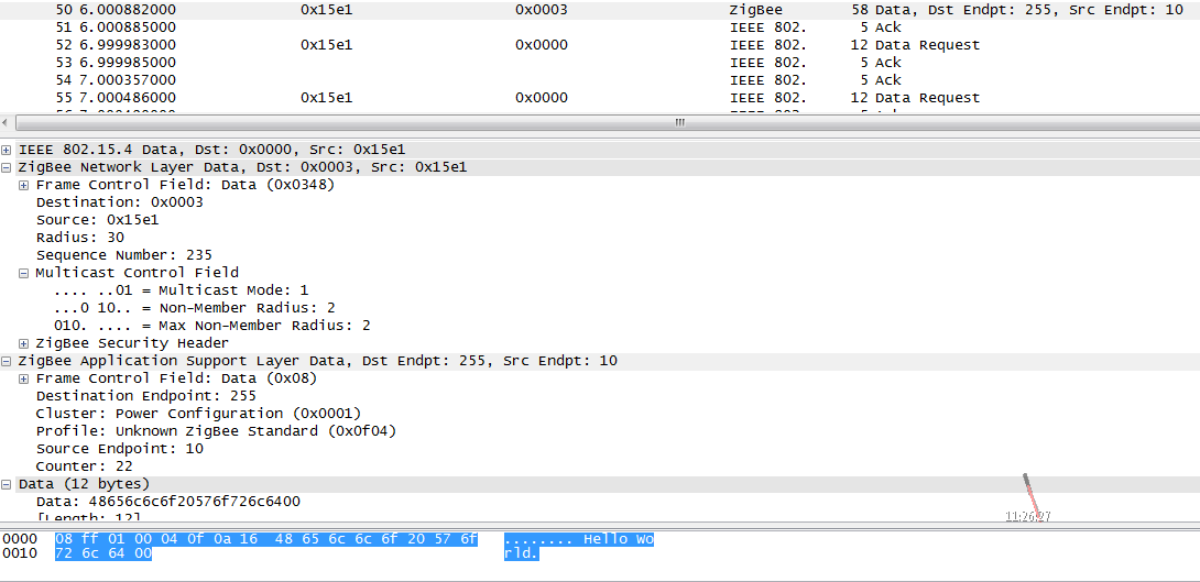

1.check the number of groups,
    aps_CountAllGroups return 0

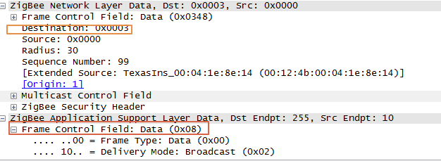

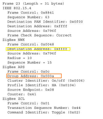

2.to allocate new group table then aps_AddGroup
  apsGroupTable=(apsGroupItem_t*)osal_mem_alloc( sizeof( apsGroupItem_t ) * APS_MAX_GROUPS);
   then call aps_AddGroup to be "FaultISR"
3.change the short address , group id or boradcast network address.
   but the group member no work also.
4.have anyone more suggest ?

void GenericApp_Init( uint8 task_id )
//faultisr
//apsGroupTable=(apsGroupItem_t*)osal_mem_alloc( sizeof( apsGroupItem_t ) * APS_MAX_GROUPS);
//define group item
SampleApp_Group.ID = 0x0003;
osal_memcpy( SampleApp_Group.name, "3", 1 );
//dest network address
GenericApp_DstAddr.addrMode = (afAddrMode_t)afAddrGroup;
GenericApp_DstAddr.endPoint = GENERICAPP_ENDPOINT;
GenericApp_DstAddr.addr.shortAddr = SampleApp_Group.ID;
//GenericApp_DstAddr.addr.shortAddr = 0xFFFF; //broadcast address
//group add ,check the return
groupStatus=aps_AddGroup( GENERICAPP_ENDPOINT, &SampleApp_Group );
//to check the number of group in table
count=aps_CountAllGroups(); //*always get "0"
