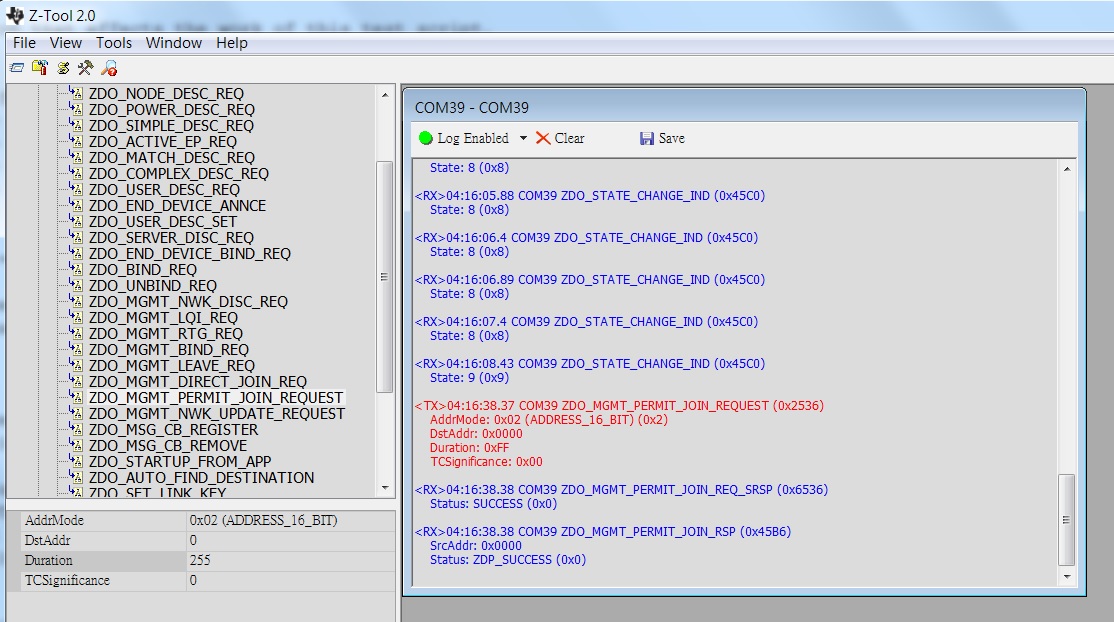

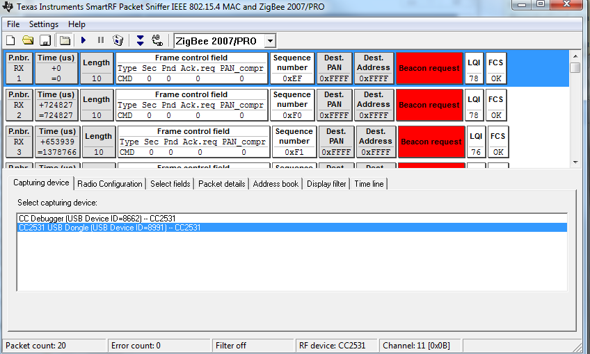

How do I stop the zigbee from advertising. Like BLE does it have a push button. Cos the red LED keeps blinking continuously
1. It should be no problem to use new IAR to compile old IAR project.

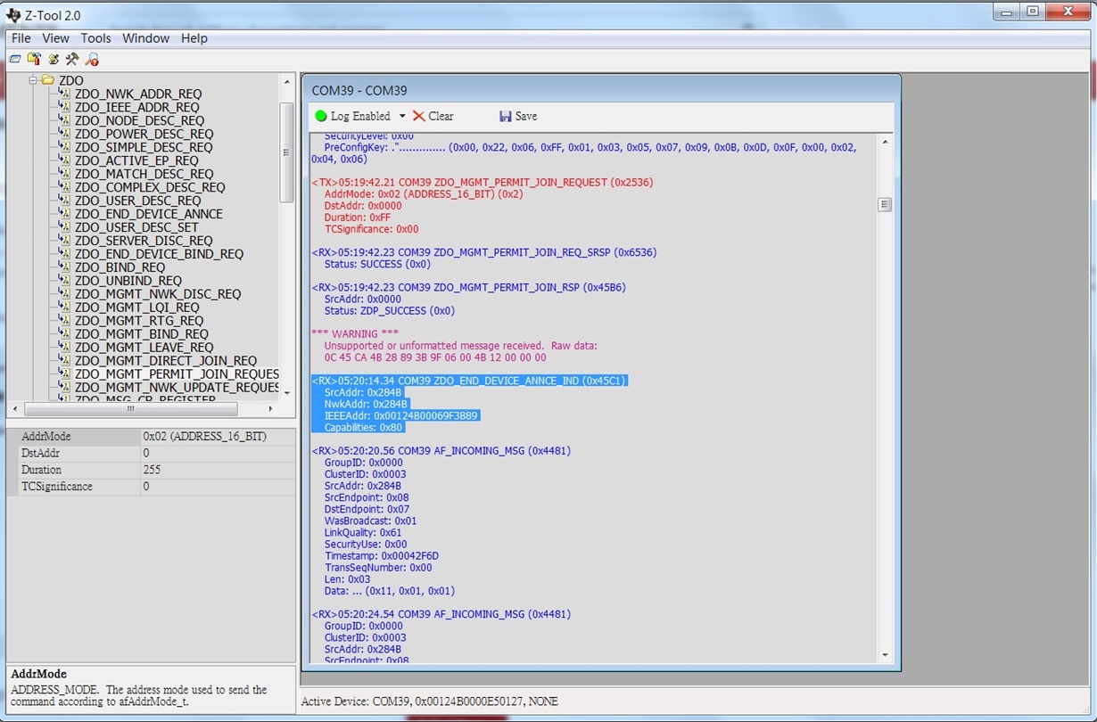

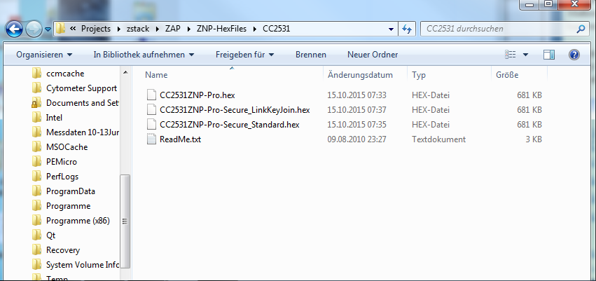

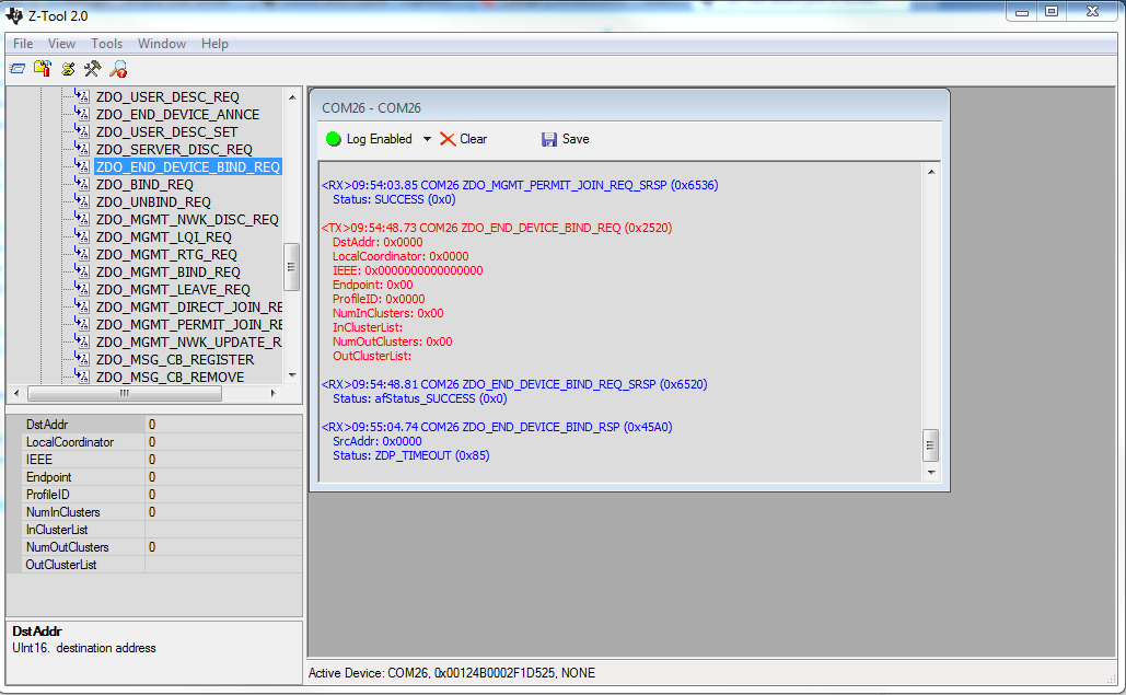

2. The coordinator is not prebuilt in CC2531 ZNP. It it set by ZAP which is ZTool in your case.
I suspect your SensorTag and coordinator are not on the same channel. I suggest you to change -DDEFAULT_CHANLIST to 0x07FFF800 which would make SensorTag scans all Zigbee channels to find Zigbee network to join.
