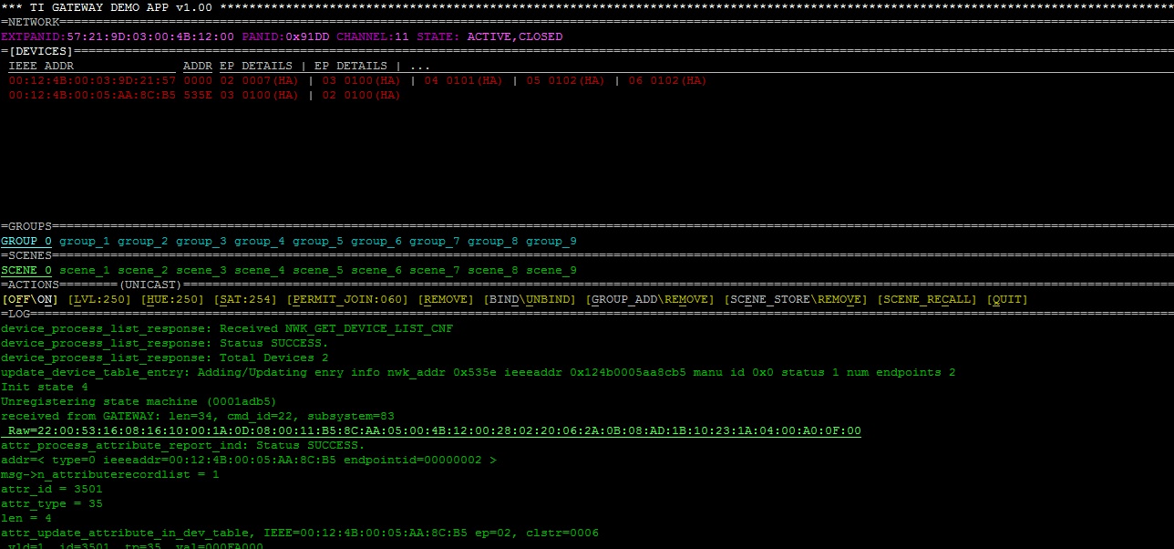

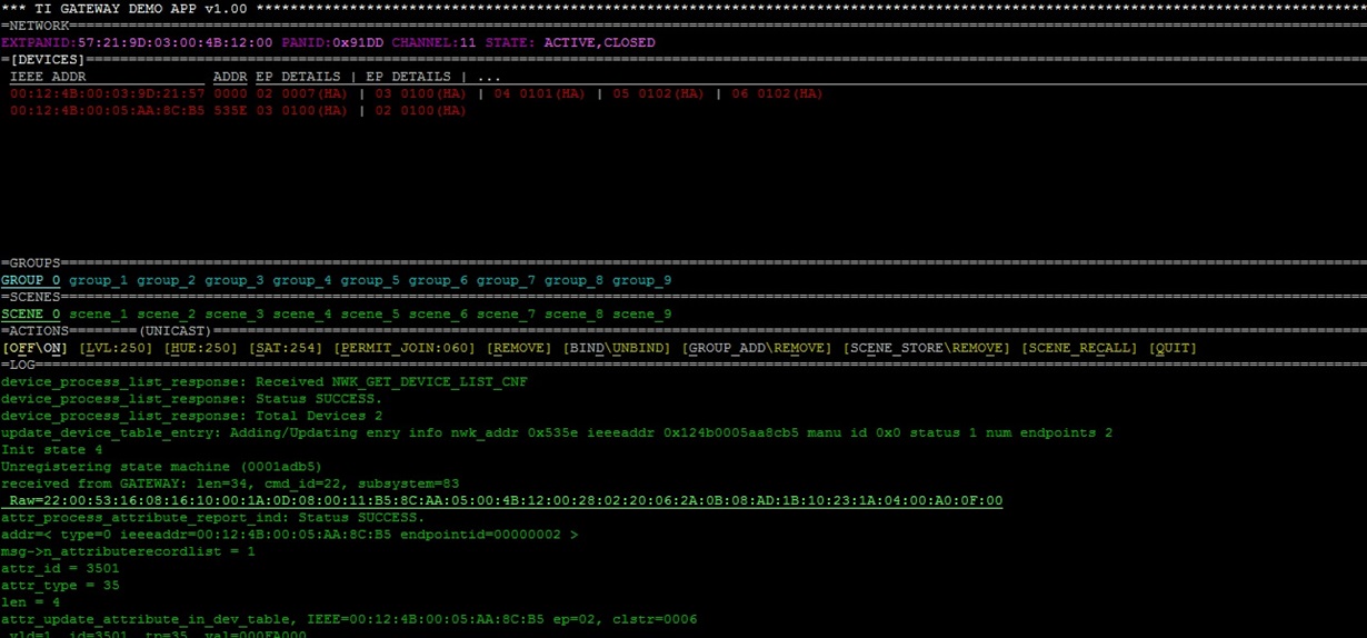

Hi
I want to change channel and PAN ID of my linux gateway.
i edit config.ini then restart z-stack linux gateway.
But channel and PAN ID don't change after restart.
Please help me.
I can reproduce your issue now. As described in Section 6.2 in Z-Stack Linux Gateway User Guide.pdf, you can change the channel or PAN ID for the network in the config.ini file. However this file is only read once at start-up. To change either of these parameters, you can modify the config.ini file, and do a hard-reset by pressing the “X” (uppercase) shortcut key. This has to be done in start_application and you will see new PANID.
