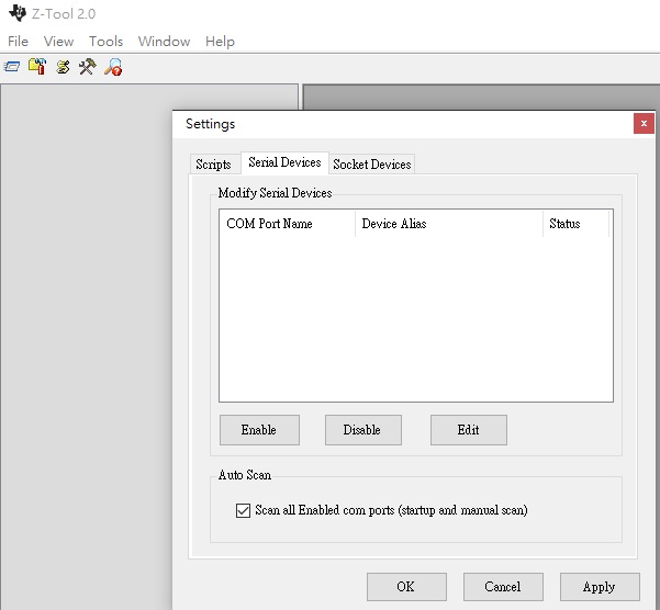

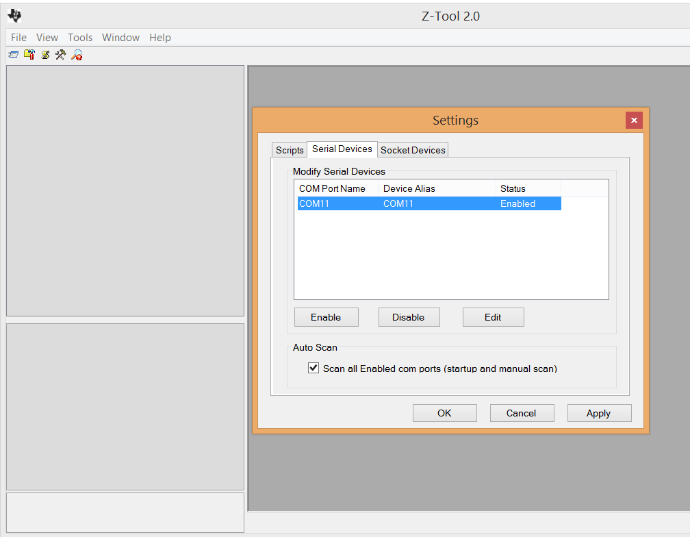

Even with z-tool, whenever I replug the USB stick and click "Scan for Devices", it takes 1 minute for the z-tool to detect the connected znp device. I think the same thing is happening with znp-host-framework.
can you please let me know whether is it the same behavior with z-tool at your end or is it detected instantaneously?
In my case even after COM11 appears in device manager (or /dev/ttyACM0 on linux), it still takes some time to respond to messages. Is it required to update any drivers?
