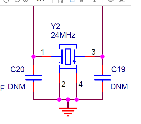

CC2630- load capacitance of 24 MHz crystal
EVM of CC2650s don't have a load capacitance at 24 MHz crystal.

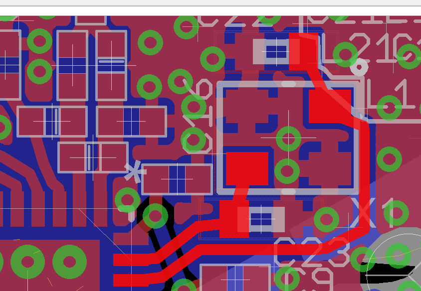

the datasheet defines the load capacitance between 5-9 pF. As I know, parastic capacitance is considered between 3-5 pF. Is it a wrong assumption? Is the layout design to have between 5-9pF capacitance for the 24 MHz crystal or would it be high chance to have a capacitance between 5-9pF if no load capacitance is used?
On my layout, one trace has 3.3 mm, the other one has 8.6 mm length.
http://processors.wiki.ti.com/index.php/CC26xx_Tips_and_Tricks?keyMatch=cc26xx%20tips&tisearch=Search-EN
says, higher load capacitance may damage the IC, is there any risk that IC may be damaged if the load capacitance is below 5pF?
