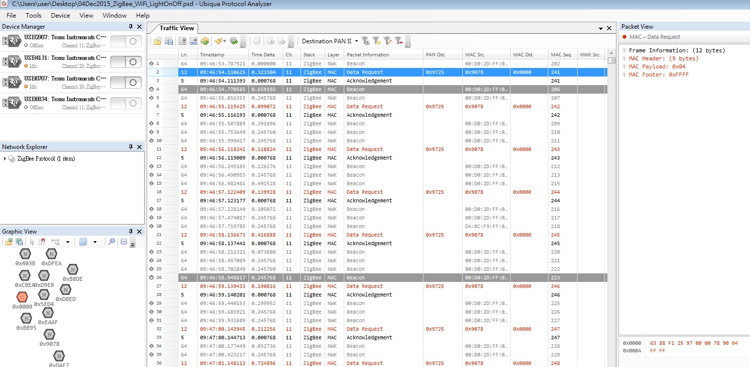

  4. Test case 1:- No WiFi traffic only Light On. Using the menu in the start_application running on BBB connected to ZNP, I can switch on the Light. I can also see 4 packets between ZNP and ZED along with ACKs in the TI Sniffer (attached). This works fine. Please see 04Dec2015_LightOn_Works_NoWiFi.png.
  5. Test case 2:- No WiFi traffic only Light Off. Using the menu in the start_application running on BBB connected to ZNP, I can switch off the Light. I can also see 4 packets between ZNP and ZED along with ACKs in the TI Sniffer (attached). This works fine. Please see 04Dec2015_LightOff_Works_NoWiFi.png
  6. Test case 3:- WiFi Traffic and Light On; but struck!!!!. Now for a couple of times On/off toggling  worked and then it got struck. Atleast it is proven that with WiFI traffic ZigBee packets suffer collision issues. What I mean by struck is that there is no change in status of light (even no commands are sent over the air). In the start_application log (04Dec2015_LightOff_Failure_WiFIStreaming.png, 04Dec2015_LightOn_Failure_WiFIStreaming.png), I see that there is a pending attribute read and also aging_engine has kicked in and the aging timer is killed. I am able to see that the SmartRF05EB Light is still enrolled into the ZNP as the short address, PAN-ID are intact. After WiFi traffic streaming was stopped, even the On/Off light command did not work.  Looks like there is no recovery for the start_application and I could not proceed further, Is there any configuration settings that will solve this problem? Or any code changes that will help to drop packets if they cannot be serviced and move forward to the next trigger to send On/Off Light command? Please help.
  7. I have also captured the over the air traffic using TI sniffer for all the above test cases. Please see attached 04Dec2015_ZigBee_WiFi_LightOnOff.psd.
