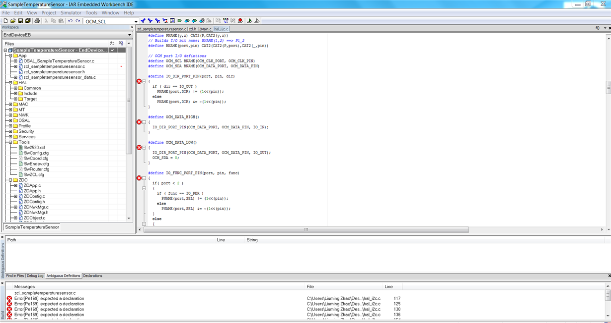

    I always got several errors after I included and compiled "hal_i2c.c" in my application files. I have spent several hours attempting to figure out what goes wrong in my code. Could you please give me some advice on how to debug those errors indicating that "expected a declaration"? I also attached a picture.
    (I did not change anything in my hal_i2c.c file except defining my own OCM_CLK_PORT, OCM_CLK_PIN, OCM_DATA_PORT, and OCM_DATA_PIN for SCL and SDA)

  • Do you put hal_i2c.c and hal_i2c.h under HAL->TARGET->CC2530EB->Drivers?
  • Could you attach the list of additional include directories.
    Project options (Alt+F7) -> C/C++ Compiler -> Preprocessor (tab)
  • Hi YK Chen,
    Thank you for your help. I already put those files in this location, but the errors still appear.

  • In your case the hal_i2c.h should be placed under include, not in drivers.
  • Hi Igor Sherer,
    Thank you for your help. I also tried to place the file under include, but the errors still appear.
  • Ok, where did you copy these files on your PC?
  • Hi Igor Sherer and YK Chen,
    Thank you for your help. I already solved the problem. It turns out that the predefined file path for "ZDObject.c" is not correct so that the definition and declaration of variables "port" and "pin" are not existed under this condition.
