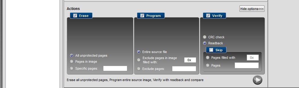

  • I'm having less luck with my new CC2650 LaunchPad.
    Flash Programmer 2 can see the device but errors with "Error occured at addr: 0x00000000, writing 16768 bytes." when trying to flash the new firmware. I just selected the hex file and checked the Program action. Maybe I'm missing something but I couldn't see anything else obvious.
    The SimpleLink Starter app isn't in the Android app store and the SensorTag one can't see the device. It's discoverable via Bluetooth but pairing is refused too.

  • Same versions as you have. I selected XDS110/CC2650 under connected devices, selected the hex file, checked program, entire source file and when clicking the button with the triangle I get the following output:
    >Initiate access to target: XDS-L1001993.
    >Reading file: C:/Users/fred2/Downloads/CC2650LaunchPad_BLE_All_v0_90.hex.
    >Start flash programming ...
    >Flash loader reported an error (4)
    >Failed to write 37276 bytes to address 0x00000000.
    >Reset target ...
    >Reset of target successfull.
    Connecting to and reading from the device seem to work OK.

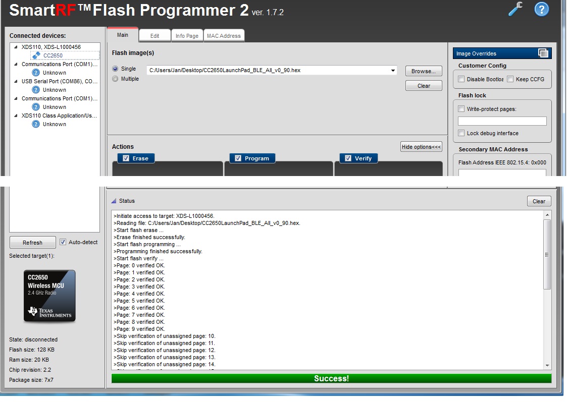

  • before programming flash has to be erased - click all 3 button as you see below:
  • Thanks jan2809, that's probably it - user error. I assumed Erase was if you just wanted to erase the device and that Program would automatically overwrite what's in the flash. I can't check until I get home but I'm sure that selecting all 3 options will do it.
