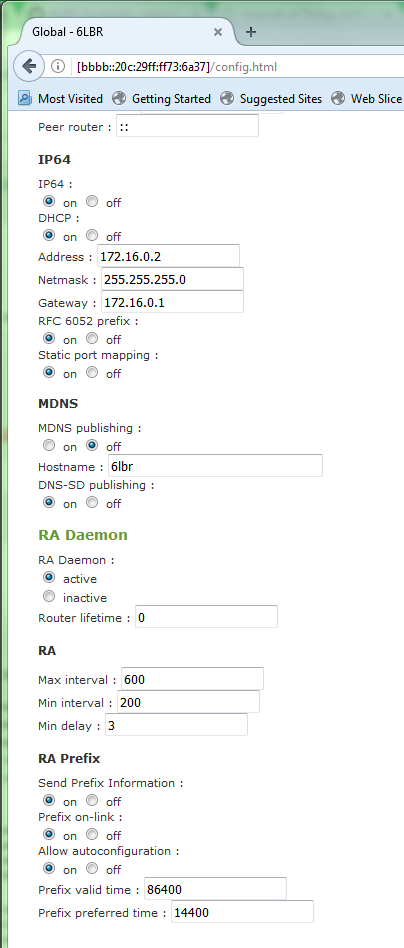

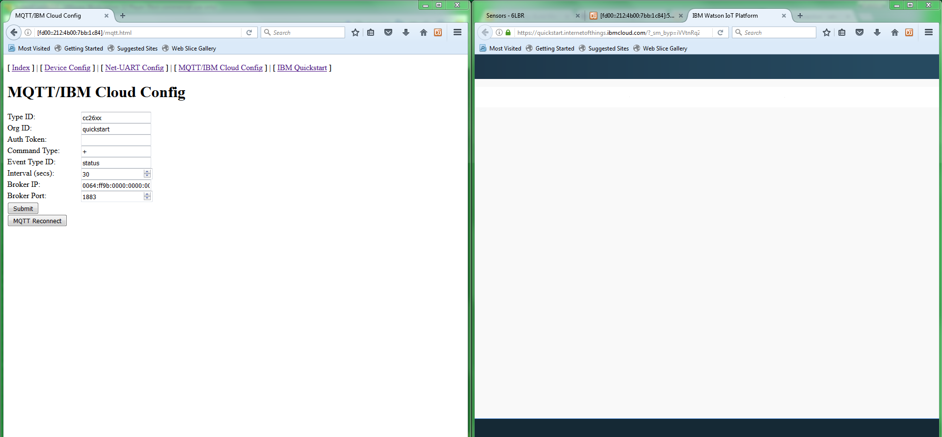

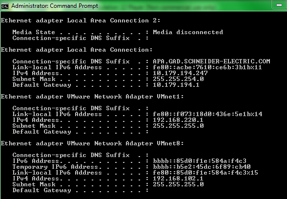

I am trying to connect to IBM quick start from the web sever running on CC2650 sensortag.
I am able to get the sensor data on the page. But when i am trying to connect the IBM quickstart i am not getting the sensor data on the cloud
my Wrapsix config is as followes
/* +++ CONFIGURATION +++ */
#define INTERFACE "eth0"
#define PREFIX "64:ff9b::"
#define IPV4_ADDR "192.168.1.150"
#define HOST_IPV6_ADDR "bbbb::111"
#define HOST_IPV4_ADDR "192.168.1.45"
/* --- CONFIGURATION --- */
i am running this by using a command wrapsix &
