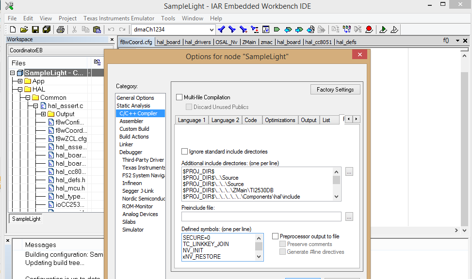

Hello Sir,
I have made some changes in the file hal_board_cfg.h,but when I compile the code I got the error.
Error[e46]: Undefined external "dmaCh1234" referred in hal_aes ( C:\Texas Instruments\Z-Stack Home 1.2.2.42930\Projects\zstack\Libraries\TI2530DB\bin\Security.lib).
I am unable to figure out the solution of this problem.
Thanks !
Hello sir,
I am compiling the project SampleSwitch from the Home Automation profile,Since I am using the Custom Board with CC2530 on it,after making changes in the hardware abstraction layer(HAL) accordingly i build and compiled the program accordingly,but during linking ,compiler throws this error.
Error[e46]: Undefined external "SSP_CCM_Auth_Encrypt::?relay" referred in APS ( C:\Texas Instruments\Z-Stack Home 1.2.2.42930\Projects\zstack\Libraries\TI2530DB\bin\Router-Pro.lib )
Error[e46]: Undefined external "SSP_CCM_InvAuth_Decrypt::?relay" referred in APS ( C:\Texas Instruments\Z-Stack Home 1.2.2.42930\Projects\zstack\Libraries\
since both of these files are declared inside the hal_ccm.h and this file is already included,still after compiling i am getting the same issue.
Thanks!
Warning[w7]: Module hal_aes declared twice, once as program and once as library. Redeclared in file C:\Texas Instruments\Z-Stack Home 1.2.2.42930\Projects\..
Does this warning causing any problem.?
Hello Yikai sir,
I got a problem while compiling my code ,I have made changes in the HAL layer since custom SoC is been used in my project based on cc2530.
Error[e46]: Undefined external "dmaCh1234" referred in hal_aes ( C:\Texas Instruments\Z-Stack Home 1.2.2.42930\Projects\zstack\Libraries\TI2530DB\bin\Security.lib.
But when I changed the SECURE= 1 to SECURE =0 in the preprocessor tab ,define symbol in the project options,program compiled successfully,
I think my understanding on this project is little misguided here ,can you please correct?
Thanks!!!
