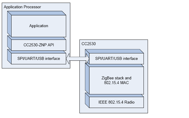

I wanna develop ZigBee application like ZAP-MSP430-1.0.0, use "host" processor to control CC2530-ZNP,
but my host processor is PowerPC.
How should i do? Can u give me some instructions?
Do i need ZNP library to accomplish this work?

  • The source code for the ZNP libraries was released with 2.3.0-1.4.0, swrc128.zip, found here:
    http://focus.ti.com/docs/toolsw/folders/print/z-stack.html
    The example code for how to control the ZNP as its host via UART/SPI is known as ZAP (ZNP Application Processor) and is swrc173.zip, found on the above listed page as well. Z-Stack 2.3.1 and ZAP 1.2.0 will be released within weeks. And a ZNP Mini-kit with more examples of how to control the ZNP is due out late summer or fall.

  • ZNP is just another sample application:
    C:\Texas Instruments\ZStack-CC2530-2.3.0-1.4.0\Projects\zstack\ZNP\CC2530DB
    "ZNP Library" might be just the ZNP sample application, pre-built, so you don't have to buy the 8051 compiler - you will need the ZAP installer found on the same page as Z-Stack which places the ZNP .hex files here:
    C:\Texas Instruments\ZAP-MSP430-1.0.1\Projects\zstack\ZAP\ZNP-HexFiles
    I don't have details on the ZNP Mini-kit - I suppose it will be similar to a former kit where a small, low memory, low cost MSP is connected via SPI to the CC2530ZNP on a USB stick.

    1. Yes, the ZNP binaries are provided and you can just load it into a CC2530. TI also provides the source if you want to change stuff, but I just use the pre-built binaries.
    2. Yes, the interface is almost the same as the CC2480 but with additional features, ZB Pro, fragmentation, etc.
    3. Yes, license agreement says that it must be used on CC2530
    4. Yes, in fact that's one benefit of using the pre-built ZNP libraries; they've been tested by TI.

    ZNP implements SPI interface with two pin configurations as explained in the ZNP Interface specification documentation (main pin configuration and alternate pin configuration). While this is a difference on what pins ZNP uses to talk to application processor ZNP functionality do not differ.
    In the ZNP Mini Kit examples callbacks are enabled while doing start up by using the function
    setCallbacks(CALLBACKS_ENABLED);
    Suyash Jain

  • The source code an project files to build ZNP are included in the "full" version of the ZStack-CC2530-2.4.0-1.4.0 release ( http://focus.ti.com/docs/toolsw/folders/print/z-stack.html ). Once you install this product, look in: C:\Texas Instruments\ZStack-CC2530-2.4.0-1.4.0\Projects\zstack\ZNP and you should find everything you need.
