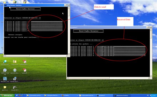

    I want also to know the frame format that the sender uses to send data.
    I give you an example of transmission
    thx
    The perl script interface for SmartRF Studio 7 is not yet completely finished, and still lacks some of the essential API documentation.
    Below you can see the prototype of each of the C++ function that is called by the perl module dal_ext.pm. You will find a perl function for each in that file.
    Class DALExt
    // Get status of last operation
     int getStatus(void);
     // Get error message by error number
     char *getErrorMessage(int errNum);
     // Get latest error message
     char *getErrorMessage(void);
     // Confiuration path of DAL
     char *getConfigPath(void);
     // Get list of connected EB devices
     char *getEbDeviceList(void);
     // Get list of defined RF devices
     char *getRfDeviceList(void);
     // From RF devicelist
     char* getDeviceType(const char* szDeviceName);
     char* getDeviceBrief(const char* szDeviceName);
     Class DALExtDevice
    // DAL config
     char* getDeviceBrief(void);
     char* getDeviceDescription(void);
     char* getDeviceRegisters(void);
     char* getDeviceUrl(void);
     char* getDevicePhoto(void);
     char* getUiClass(void);
     char* getStrobes(void);
     char* getEasyModeSettings(void);
     char* getTypicalSettings(void);
     char* getRegInfo(char *regName);
     // DAL access
     int connectEbDevice(char *usbDid);
     int readRegister(char *regName);
     void writeRegister(char *regName, unsigned short value);
     void setRegPacketTx(void);
     int initTx(void);
     int sendPacket(char *buffer,int fIeee);
        void setRegPacketRx(void);
     int initRx(void);
     int isPacketReceived(void);
     char* readPacket(void);
    In the packet sniffer you can see the format of packet when using the sendPacket function. An IEEE 802.15.4 compliant header is prepended before the payload bytes.
    We are aware that this module lacks documentation, but I hope this gives some useful information about the API to use.
