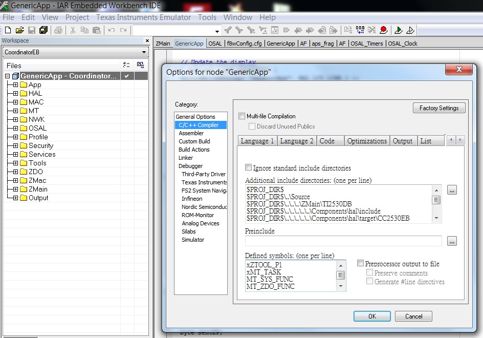

    But when I run the program , I found that str was not output . All I got in the terminal is "H▒IEEE: 00124B00019C2EF5▒▒A▒▒▒H▒ZigBee Coord Network ID: 86FB". All these stuffs comes from the funciton void nwk_Status( uint16 statusCode, uint16 statusValue ). And I still found if I did not enter ZTOOL_P1 in the Preprocessor of Option, nothing output in the terminal. That's why?
  • Try to disable ZTOOL_P1 and MT_TASK in Defined symbols.

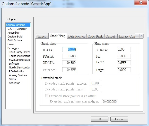

  • I disabled ZTOOL_P1 and MT_TASK in Defined symbols.But I got such link error:
    Error[e104]: Failed to fit all segments into specified ranges. Problem discovered in segment XDATA_N. Unable to place 2 block(s) (0xc02 byte(s) total) in 0xa89 byte(s) of memory. The problem
    occurred while processing the segment placement command "-P(XDATA)XDATA_N=_XDATA_START-_XDATA_END", where at the moment of placement the available memory ranges were
    "XDATA:1477-1eff"
  • I don't think this is caused by removing those two Defined symbols. I remove it from my GenericApp example and don't see the same problem. I think you might use a large array to cause this issue.
  • You are right. I changed the options--General options--Stack/Heap--XDATA value, and the link error was gone. Thank you.
    But I still not get the output in terminal. BTW, now I'm using smartRF05EB to debug the program. Now there are nothing in the terminal.
  • You have to define ZTOOL_P2 in Defined symbols.
  • Would you please to tell me the value in option->Stack/Heap. Such as Stack sizes and Heap sizes. I always get warning when I debug the program and use "Break" in Debug menu, which said "The stack point for stack'XdataStack'(currently XData:0x0000) is outside the stack range(Xdata:0x0001 to XData:0x300).
  • Thank you. Now I debug the program in smartRF05EB board. I make sure that I run the HalUARTWrite(HAL_UART_PORT1,uartbuf,16)function, but still nothing in the terminal. Now I use USB2RS232 line to connect the  RS232 interface in smartRF05EB board . Here is my defined symbols:
    xZTOOL_P1
    xMT_TASK
    ZTOOL_P2
    MT_SYS_FUNC
    MT_ZDO_FUNC
    LCD_SUPPORTED=DEBUG
    HAL_LCD=FALSE
    HAL_UART=TRUE
    HAL_DMA=TRUE
  • Try to remove the following defines.
    HAL_LCD=FALSE
    HAL_UART=TRUE
    HAL_DMA=TRUE
  • After I tried, I found only when the Defined symbols: MT_TASK, ZTOOL_P1, and HalUARTOpen(HAL_UART_PORT_0,&uartConfig);
    HalUARTWrite(HAL_UART_PORT_0,uartbuf,16); that I could get the serial output in the termainal.
    If I disable the ZTOOL_P1, only start ZTOOL_P2, and HalUARTOpen(HAL_UART_PORT_1,&uartConfig);
    HalUARTWrite(HAL_UART_PORT_1,uartbuf,16); I still could not get the output.
