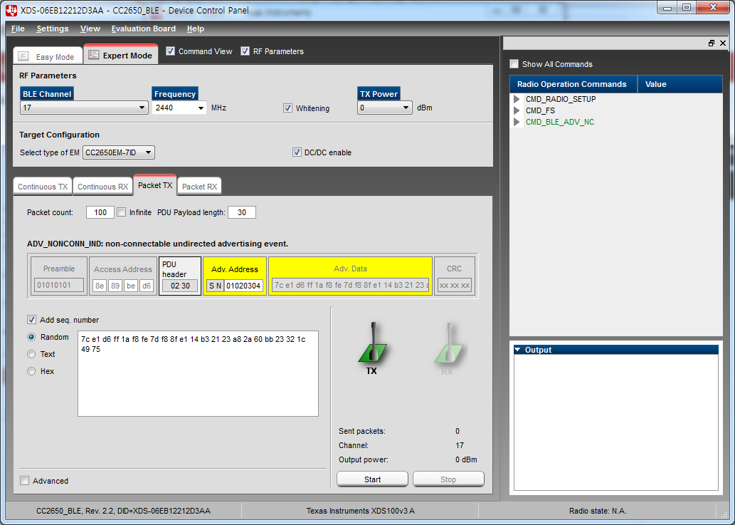

How to test CC2650 BLE module RF Performance, in Smart RF studio tool
Other Parts Discussed in Thread: CC2650
Hello My name is Yong-ha
I try to  test CC2650 BLE module RF Performance , using Smart RF Studio tool

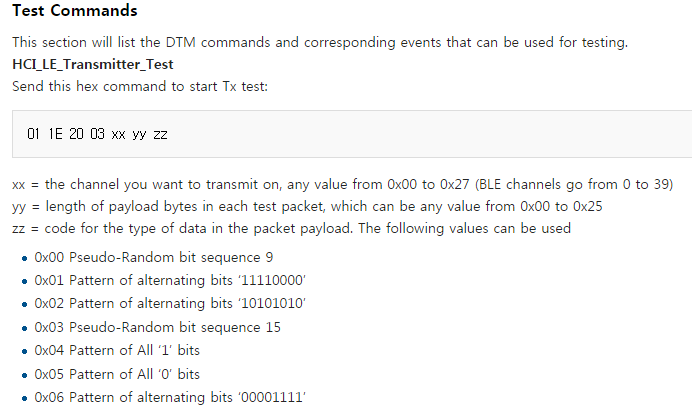

I would link to know how to change type of data in the packet payload , in Smart Rf Stduio tool
For example PRBS9(Pseudo-Random bit sequence 9) or Pattern of alternating bits ' 11110000' or 10101010' or '00001111'
Because,  each data pattern is seen another parameter RF performance
thank you.
