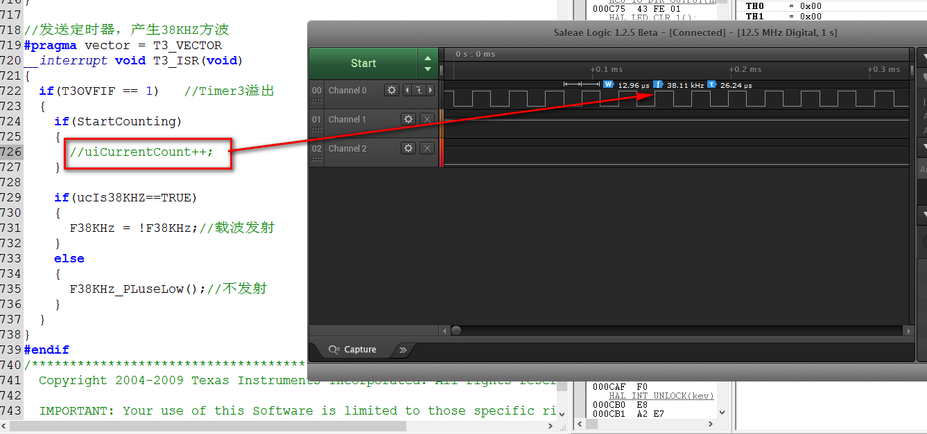

i want  to using  the  Timer3 to generate 38Khz clock.
When i try to Free-Running Mode  and UP-Down Mdoe ,it seems Timer3 is working。
 i have  not got  the right vaule to get 38Khz clock 。
as the Timer3 setting :

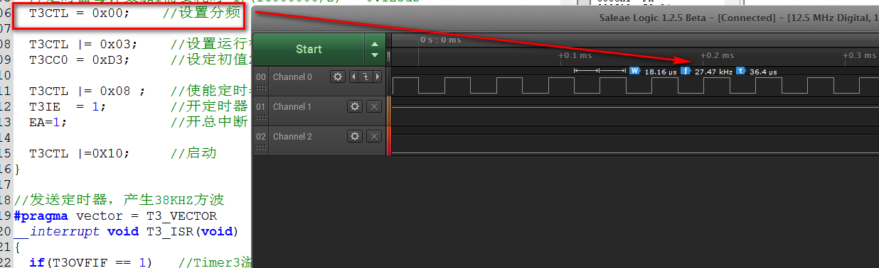

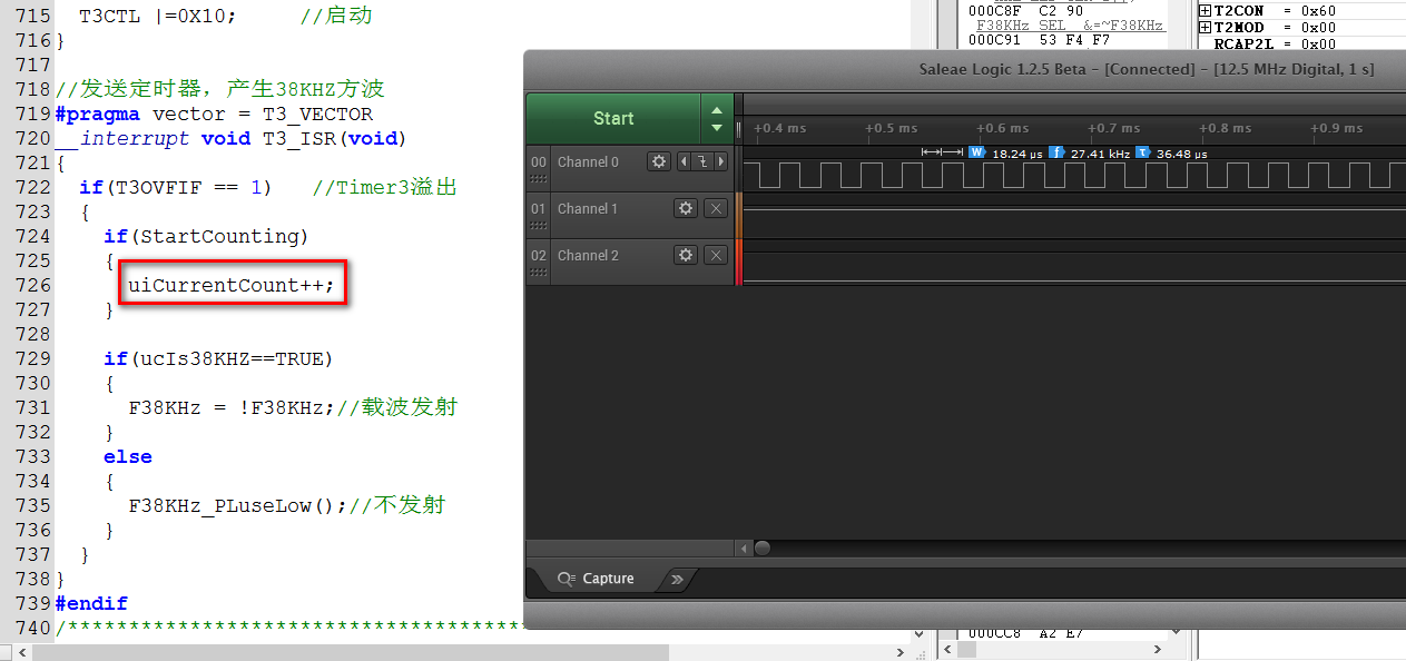

         Q1:
but  Modulo Mode seems not work, i set a break point in the interruption,
and  i found  that  the T3 have not going into the interruption。
Q2:

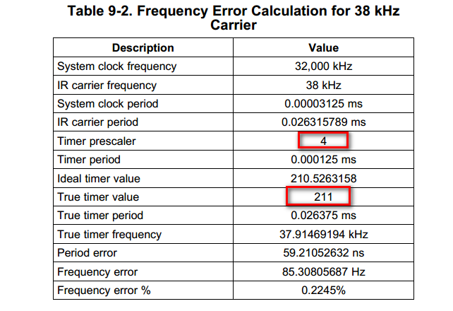

if  the system clock is 32Mhz ,what is the vaule should i set in  the Timer presaler and ideal timer value ?

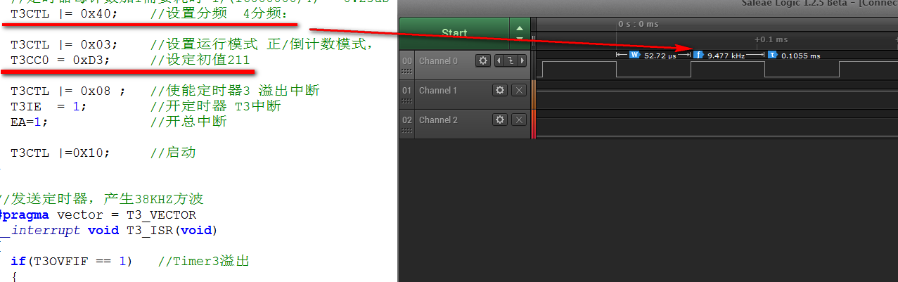

I follow this table, but  i have  not get the right clock out !

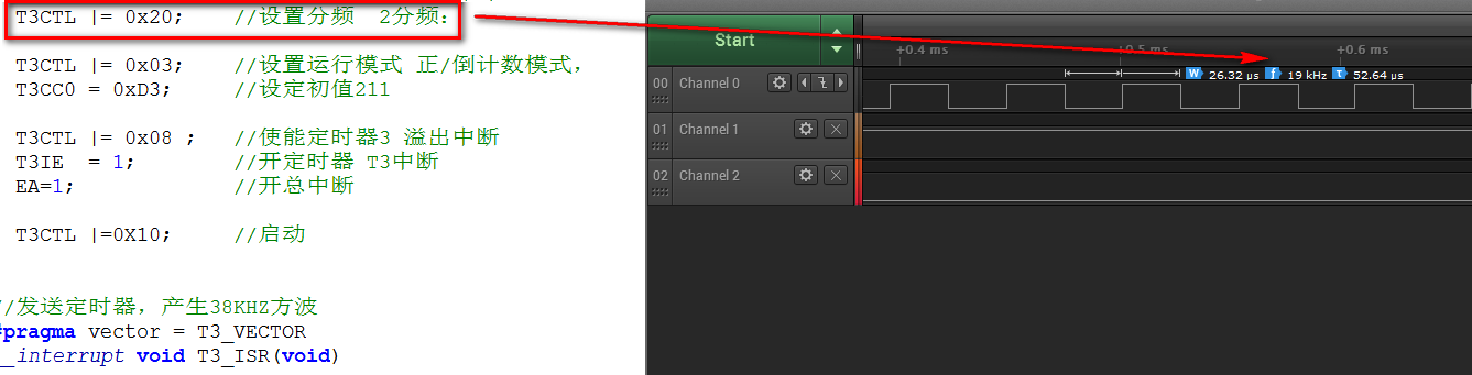

as  the table setting, 4 prescaler    ideal timer vaule  211  ====》 result clock :9.477Khz
 2 prescaler    ideal timer vaule  211  ====》 result clock :19 Khz
0  prescaler   ideal timer vaule  211  ====》 result clock :27 Khz
i am so confused ~~~~
