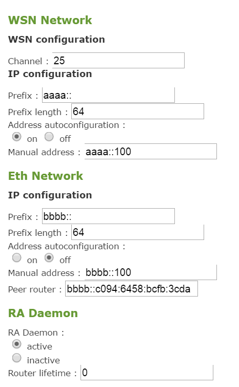

I'm running the cc26xx-web-demo application on the cc2650 and am having issues getting it to work with IBM quickstart. I have looked through the forums but non of the other posts work for me. So far we are able to connect to 6lbr and view the nodes data. Furthermore, we can ping our node with address [aaaa::212:4b00:7b5:e003]

My 6lbr settings are as follows
6lbr settings are as follows:
MODE=ROUTER
#MODE=SMART-BRIDGE
#MODE=RPL-RELAY
#MODE=FULL-TRANSPARENT-BRIDGE
#MODE=NDP-ROUTER
#MODE=6LR
#MODE=RPL-ROOT
RAW_ETH=1
BRIDGE=0
DEV_BRIDGE=br0
DEV_TAP=tap0
DEV_ETH=usb0
#RAW_ETH_FCS=1
RAW_ETH_FCS=0
DEV_RADIO=/dev/ttyACM0 #2.4GHz USB Dongle will enumerate like ACM0
#DEV_RADIO=/dev/ttyUSB1 #SmartRF06EB+CC13xxEM will enumerate like USB1
BAUDRATE=115200
LOG_LEVEL=3
Furthermore, when I run a tcp dump with "sudo tcpdump -i usb0 -v -X port 1883"
I get no information in return. Is my wrapsix setup improperly? Is there a setting I forgot to change?
