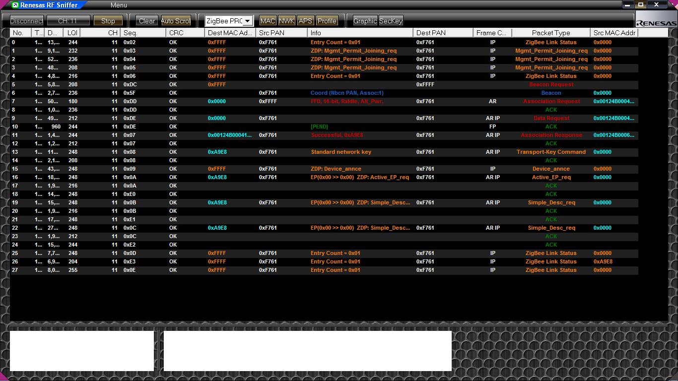

  • Can you attach sniffer log which shows your device tried to join this GW?
  • I see there are Active_EP_req and Simple_Des_req to device 0xA9E8 but there is no response. You should check why your device doesn't response to those requests.

  • This is about your ZAP so you have to check it by yourself to see why your device doesn't send response to those Active_EP_req and Simple_Des_req.
  • Hi Chen.
    Sorry for the late reply. We are able to progress with pairing touch panel with the Gateway. We found that bytes were swapped for Profile ID and Cluster ID due to which it was not getting listed in the Gateway. Post corrections this issue is resolved and it is getting listed in the Gateway node list.
