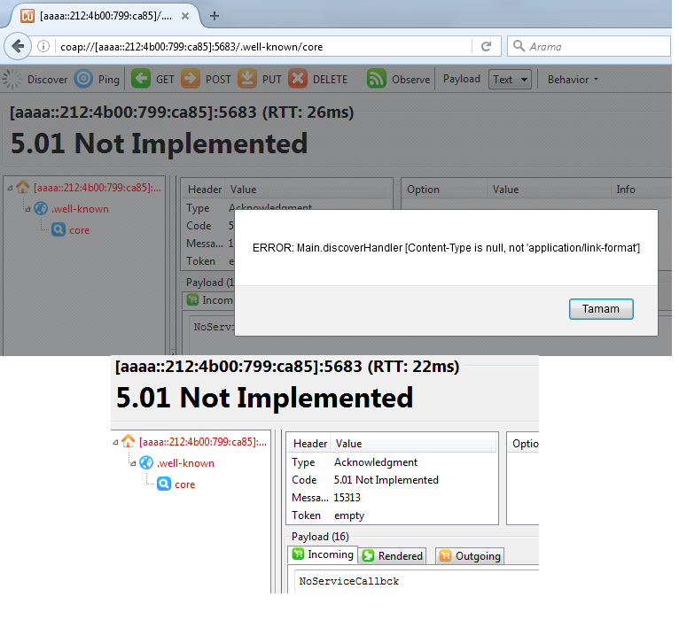

  • I could run the command and created bin field. I flashed cc2650 with the created file. But on copper I received errors below;
     Can't I run the client example on the sensortag?

  • I created the a bin file with your command and flashed to sensortag but the result is same as screenshots.
  • Do you run cc2650 er-example-server.bin on your CC2650 or cc2650 er-example-client.bin?
  • First I tried server example on cc2650, get method was working  but not put method, I tried put with toggle.
    And then I flashed client bin file on cc2650 so that did not work at all.The print screens are running client examples.
    Do I need to flash second sensortag as server to be able to try it ?
  • When you use copper plugin on Firefox, you should run er-test-server on CC2650. However, I don't know why PUT doesn't work.
