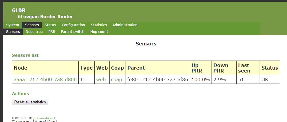

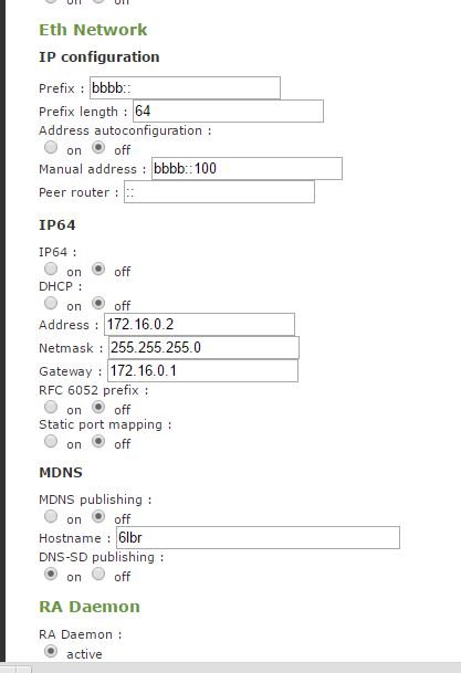

  Dear all,
I am working on 6lowpan using cc2650stk. Initialy i implemented network using BBB+cc2531(6lbr) and cc2560stk(web-demo) but i failed,Reasons are have to use latest firmware from 6lbr nd contiki.

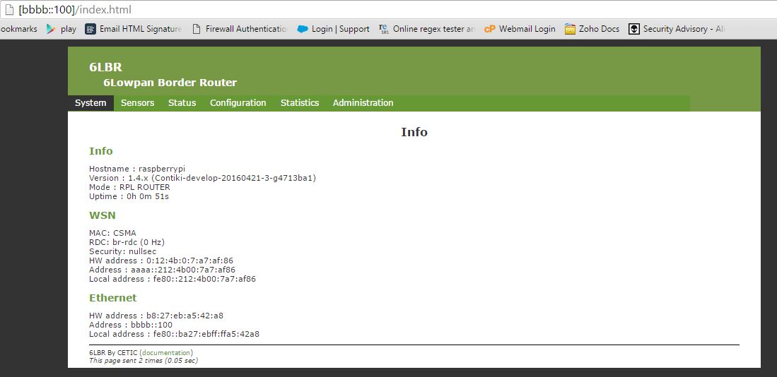

So nowi tried i changed to raspberry latestversion nd cc2650stk as slip radio ..up to now fine .But even i change the command #define RF_BLE_CONF_ENABLE =0;  i didnt see any values on web nd CoAP.    i used latest contiki head 8b3d220.

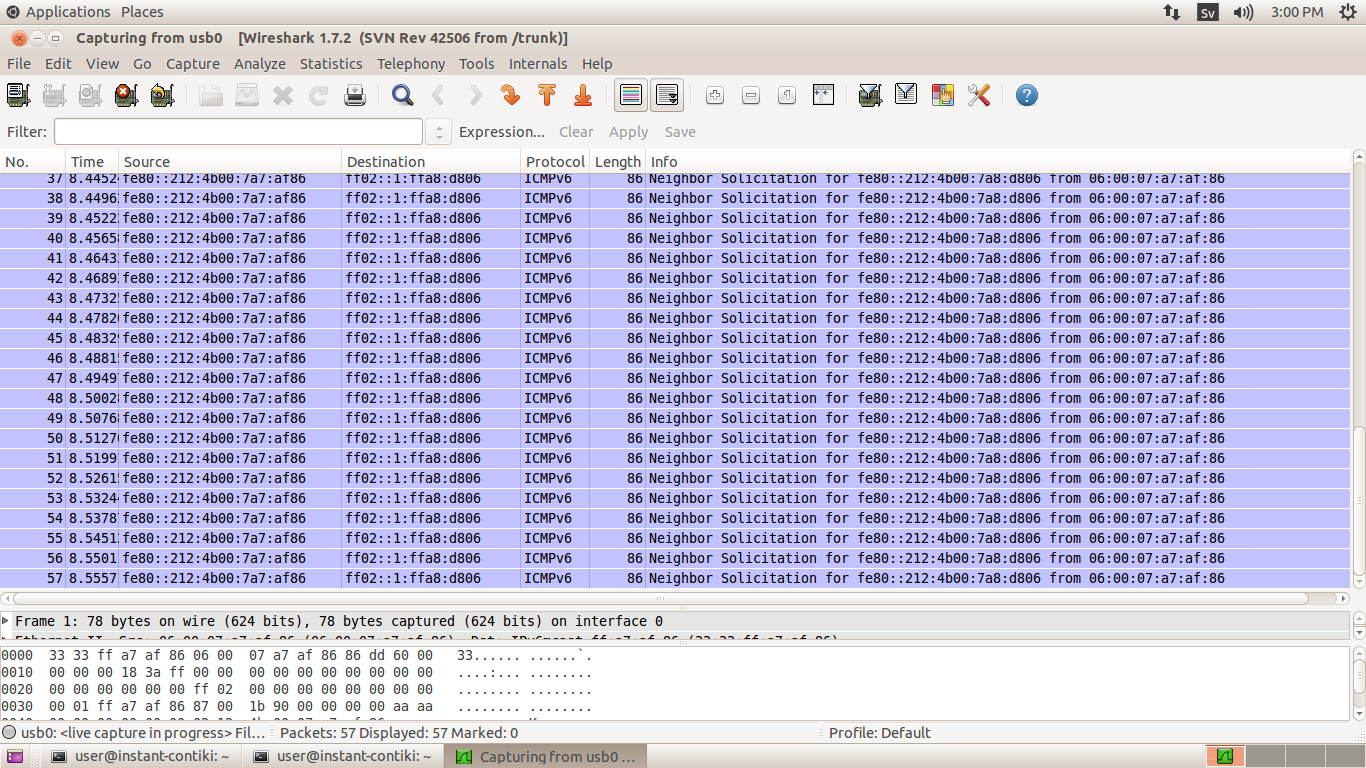

And when i sniffing the data only i saw only RPL neighbour solication messages .So no communication goig on between 6lbr nd web-demo node...

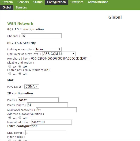

I check all configuration RDC ,channel ,PAN-id same on 6lbr nd cc2650stk nodes.
I m nt able to ping .i dont know the problem.
