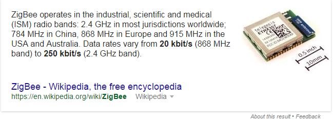

  • Hi someswara,
    The closest Mr. Yikai (16kbit/s) said is the 20kbit/s if you are using the 868MHz Zigbee frequency.
    I'm also curious why they advertise the 250kbit/s at 2.4GHz Zigbee frequency which theoretically can cover the 200Hz data sample rate.
