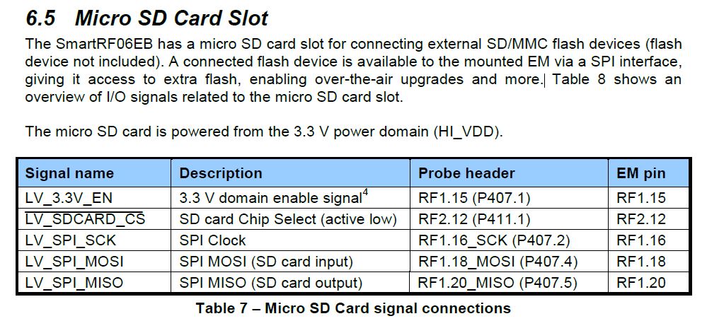

I see "SmartRF06 Evaluation Board user guide" :
over-the-air means OTA
as I know , SmartRF06EB only 125k flash , so if I want to update BLE fireware via OTA , I need to put image in SD card
and update fireware via OTA , I want to know how size about basic image ?
If I use one extra flash to save image , 256k flash is OK ?
by the way , how do I do implement OTA Function ?
