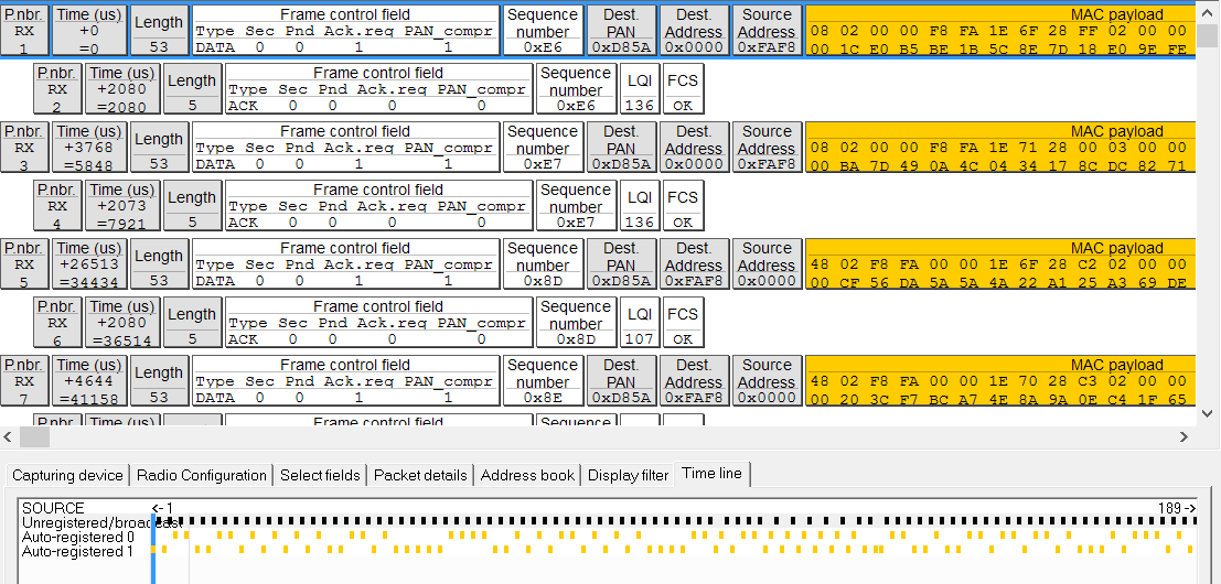

A) End device sends data to its parent with interval 50 miliseconds. POLL_RATE is also set to 50ms, QUEUED and RESPONSE POLL RATE are set to 10ms.
Packet capture from sniffer looks like this:
As I see it works fine, however this is still too slow for me.

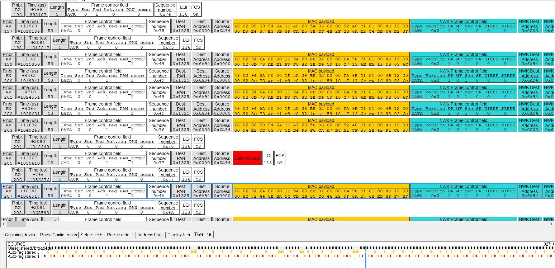

B) I change configuration to: interval = 30 ms, POLL_RATE = 30ms, QUEUED=RESPONSE=10ms. Now capture looks like this:
First of all, coordinator sends some frames of data in a row without request from end device.
What's more, after some time the communication has been lost and I can see 'Assoc Cnf fail' message on my screen. I guess that interval time is too short, but I do not know why and what can I do to improve that.
