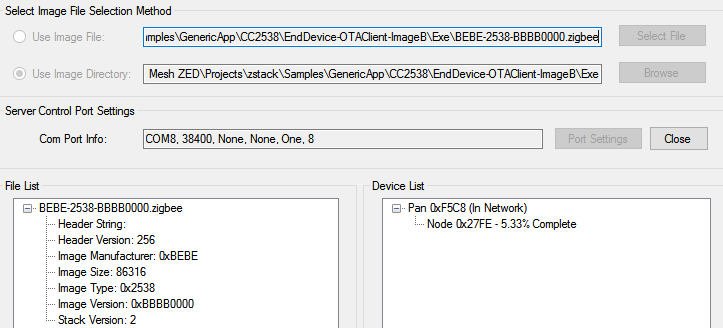

I got everything working for z-stack mesh OTA. I've used OTA Dongle Coordinator and GenericApp with ported OTA capability for end node. However, the downloading part to the end node is a bit slow. 2.48% - 3.11% takes 1 min!

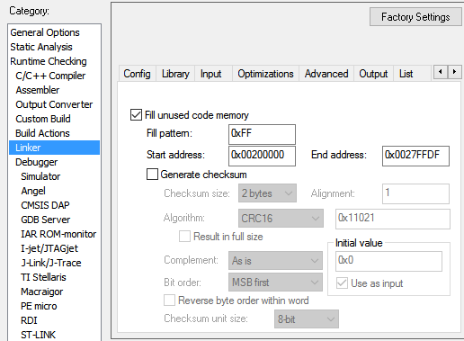

I'm using the Image A with Bootloader for my end node. I've finished compiling the Image B. I got a warning during the Image A Bootloader compilation though (see attached text file)

Wed Jul 13, 2016 12:08:41: Warning:
Verify error at address 0x0027C010, target byte: 0x00, byte in file: 0xFF
Verify error at address 0x0027C011, target byte: 0x00, byte in file: 0xFF
Verify error at address 0x0027C012, target byte: 0x00, byte in file: 0xFF
Verify error at address 0x0027C013, target byte: 0x00, byte in file: 0xFF
Verify error at address 0x0027C020, target byte: 0x21, byte in file: 0xFF
Verify error at address 0x0027C021, target byte: 0x05, byte in file: 0xFF
Verify error at address 0x0027C022, target byte: 0x13, byte in file: 0xFF
Verify error at address 0x0027C023, target byte: 0x20, byte in file: 0xFF
Verify error at address 0x0027C024, target byte: 0x21, byte in file: 0xFF
Verify error at address 0x0027C025, target byte: 0x05, byte in file: 0xFF
Verify error at address 0x0027C026, target byte: 0x13, byte in file: 0xFF
Verify error at address 0x0027C027, target byte: 0x20, byte in file: 0xFF
Verify error at address 0x0027C028, target byte: 0xC8, byte in file: 0xFF
Verify error at address 0x0027C029, target byte: 0x62, byte in file: 0xFF
Verify error at address 0x0027C02A, target byte: 0x00, byte in file: 0xFF
Verify error at address 0x0027C02B, target byte: 0x20, byte in file: 0xFF
Verify error at address 0x0027C02C, target byte: 0xD1, byte in file: 0xFF
Verify error at address 0x0027C02D, target byte: 0x4E, byte in file: 0xFF
Verify error at address 0x0027C02E, target byte: 0x21, byte in file: 0xFF
Verify error at address 0x0027C02F, target byte: 0x00, byte in file: 0xFF

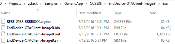

For your reference, here's the screenshot  for the file size:
I'm also attaching the screenshot of OtaServer.exe
Linker options for bootloader Image A:
