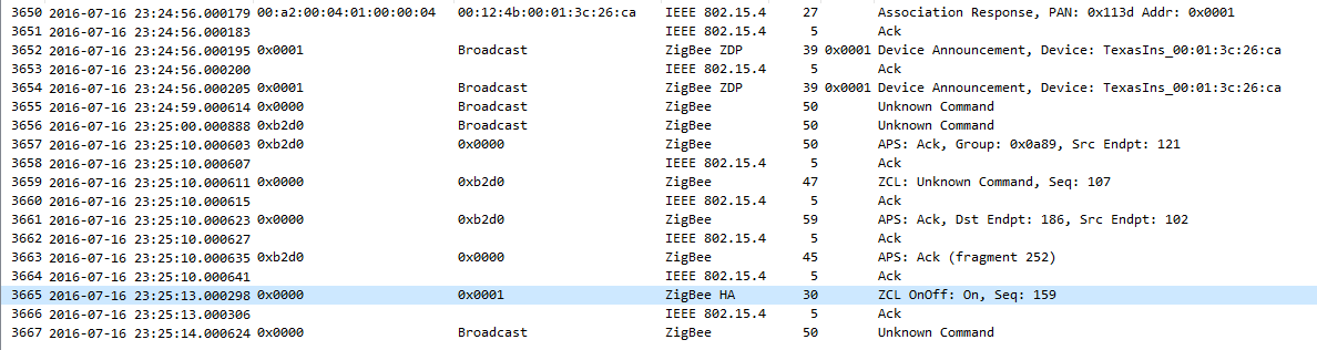

Hi Guys, i am trying to use the SampleSwitch TI example, i'll call that as MyDevice,  as a Ligth Switch togther a commercial gateway (from Mstartech)
I can see that after the the ZCL Command On/OFF my device didnt answer with ZCL Default Response. I trying to debug it but i can`t do it without an auxiliary code.
Do you can see below that the ZCL on/off was send and after it we can just see the MAC Layer mesage (802.15.4) response!
Somene had this problem?

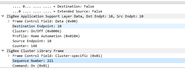

    Thanks a lot for your assistance. But i was change to the SampleLight and than i have the same problem, my Device didn't send the feedback ZCL Default Responde. I Saw a few parameters on the ZCL on/off command, probably defined in my commercial GW,  and than i think that it have an effect on the SampleLight code.
    Parameter sent in the ZCL on/off (I saw it on the Protocol Analyzer):
    Destination EndPoint: 10
    Source EndPoint: 10
    The ZCL on/off CMD from Commercial GTW:
    I have see on the SampleLight Code, in the zcl_samplelight, the follow code. i have uncoment those 3 lines and change those parameters values, i think that it probably have a relationship with ZCL On/Off CMD, below you can see those parameters values, original and the changes that i made.

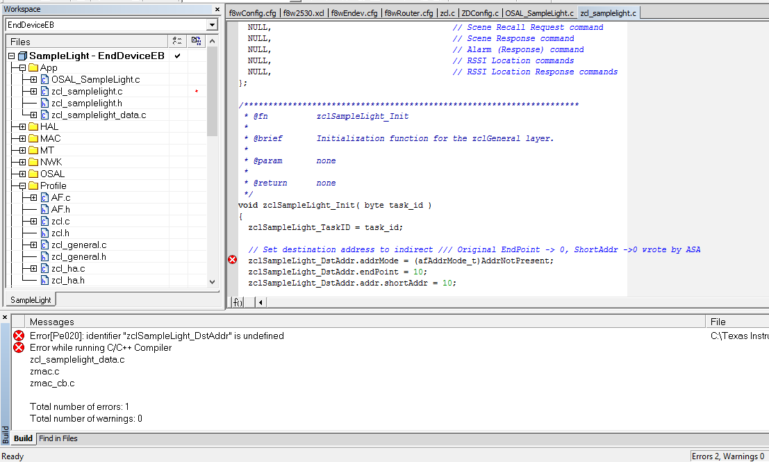

    As i trying to told you, I wrote in the simple descriptor of SampleLight the correct SRC and DEST (10), that i was see via Protocol when compared with the commercial devices, but during the compile procedure the IAR was request to declare the variables, but I do not know how to do! Would you help me, please?

    In additional about your last question, after i have uncoment, in the Simple Descriptor, the follow lines below, i got those IAR errors:
    // Set destination address to indirect /// Original EndPoint -> 0, ShortAddr ->0 wrote by ASA
    zclSampleLight_DstAddr.addrMode = (afAddrMode_t)AddrNotPresent;
    zclSampleLight_DstAddr.endPoint = 10;
    zclSampleLight_DstAddr.addr.shortAddr = 10;
  • There is a line "afAddrType_t zclSampleLight_DstAddr;" in original zcl_sampleLight.c. Do you remove it? If so, please add it back in LOCAL VARIABLES define section like the followings:
    * LOCAL VARIABLES
  • Hi Mr Yikai.
    Thanks, you were right! I have uncoment the line and right now the IAR was compile well.

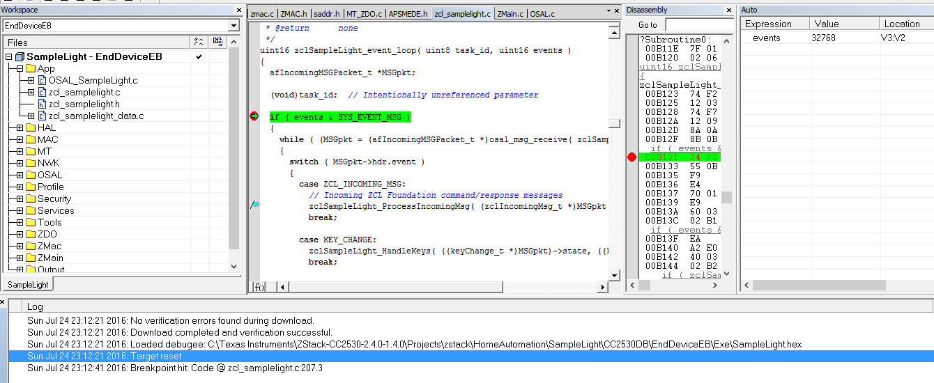

    But the sample descriptor changes alone had not effect! Maybe i need to check if the ZCL on/off CMD was triggered in the first treatment procedure.
    Would you suggest me please, how to include debugs imputs to make an inspector on ZCL incomming messages (zclSampleLight_ProcessIncomingMsg):

  • I suppose you can set a breakpoint in zclSampleLight_ProcessIncomingMsg to debug it.

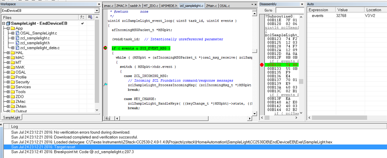

  • Hi Mr Yikai,
    in the lest week I tried to find the specific point in the ZCL incoming messages, some case during the debug starting process i receiving the message that is imposible to run and in the other i had success to starting, but in the same cases i cant see nothing. But in my last debug I saw that:
    When the variable was reached (event & SYS_Event_Msg) my device was stop to answer acknowledge and because it my commercial GTW sending a lot of ZCL:PW_ON (messages 4532-4642). As you can see below:
    I think that its happen because my breakpoint, would you can advise me please, how to make it effective to see the first and last point, in the code, that I can see the ZCL default response message?
  • The GW sends a lot of ZCL onoff command is because that there is no MAC ack and GW does retry sending.
