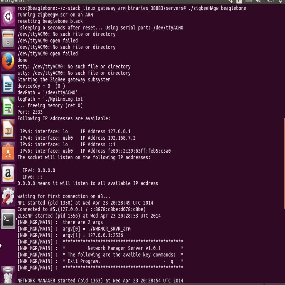

I hit ./zigbeeHAgw beaglebone
and I get following output:

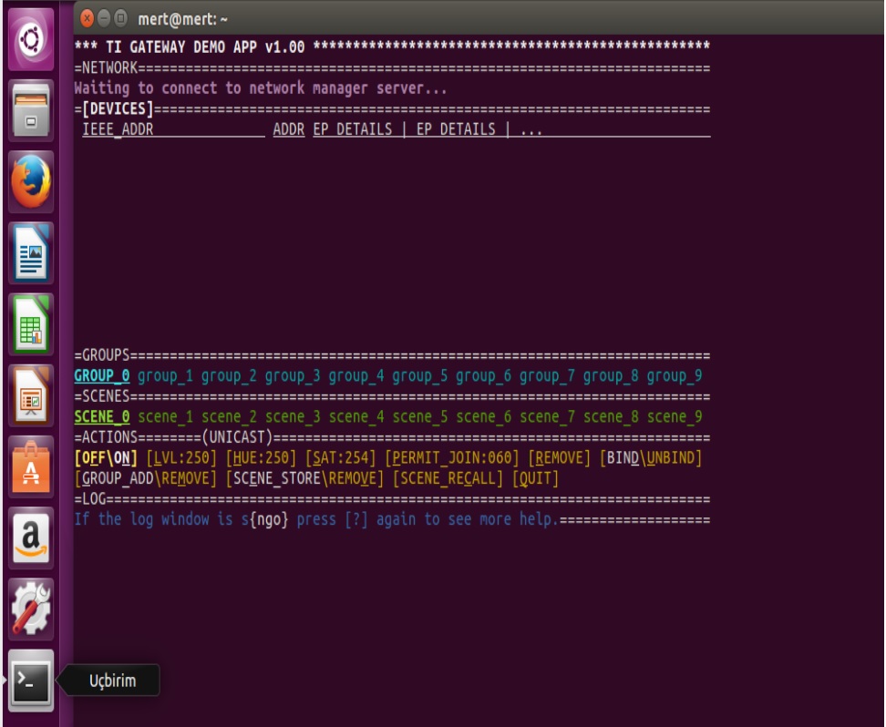

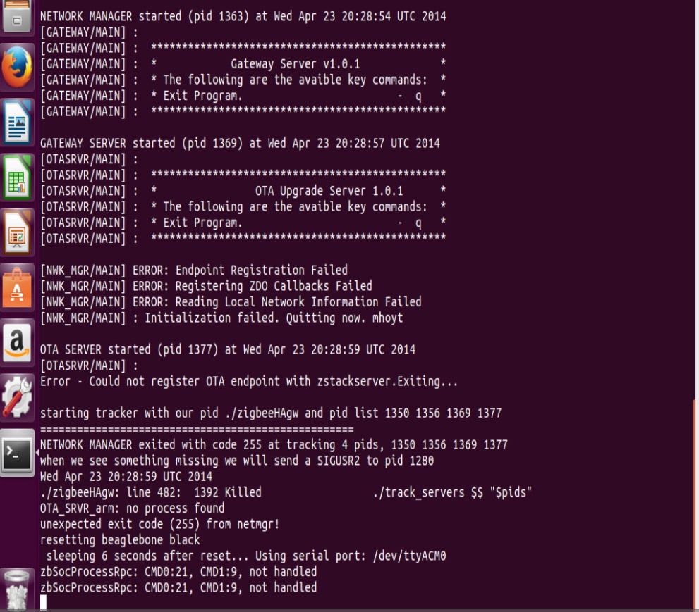

At the different shell,when application is started this command ./start_application
I get following this output.
Shortly,I think BBB and dongle are not communicating.

after i insert dongle in the BBB,yellow LED flash.And i don't see any change on dongle or terminal.How can i understand dongle pre-flashed ? Moreover,unless dongle pre-flashed,is it possible pre-flash without CC-Debugger ?
I have worked on this problems and errors for two weeks.And have ridden tens of posts and solutions,but i didn't solve it.
I have tryed Debian 7.8 and Debian 7.4 on Beaglebone,but didn't solve.
And i have tryed two different CC2531.
